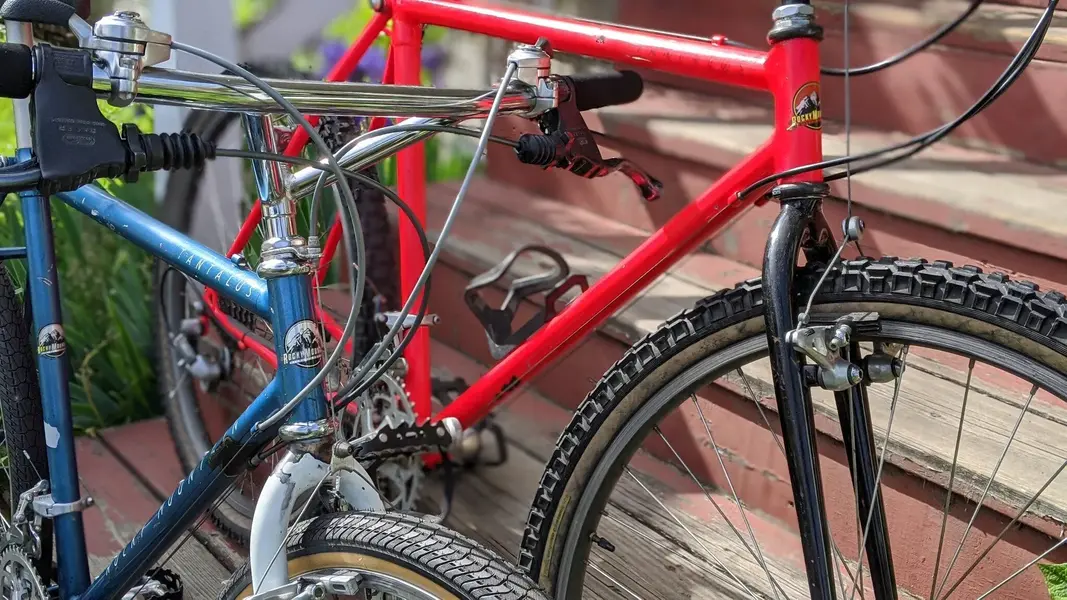

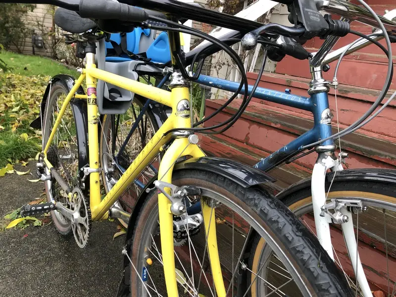

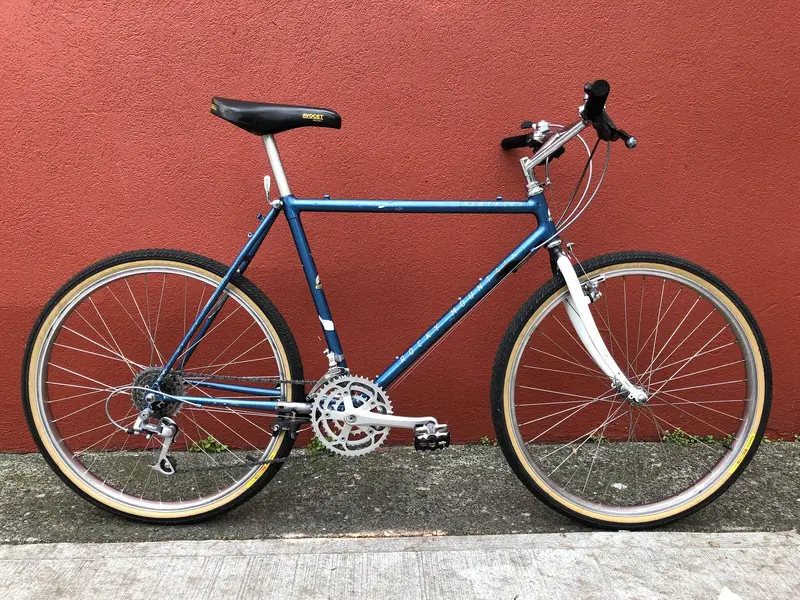

Here are a few photos of the bike as found… then cleaned up a bit (excuse the initial saddle angle, probably a few beers deep and too eager as an excuse…) along with the 1986 Catalogue specs…

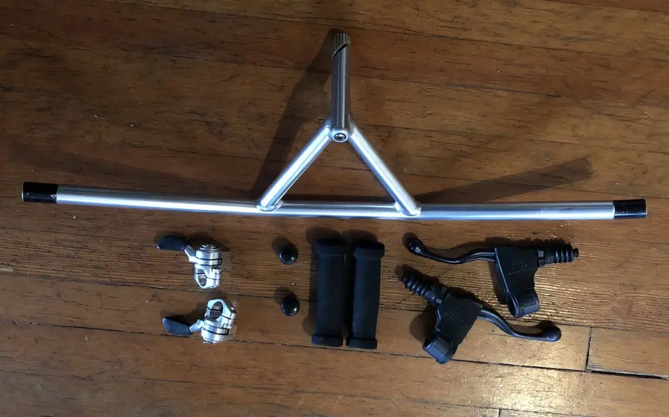

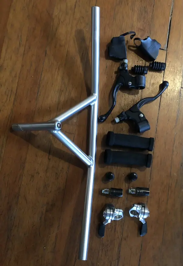

Yesterday I put the bars together, uncut very clean silver alloy Nitto bullmoose bars, a couple little extensions I fashioned for a touch extra width (some old inverse brake levers, an old stem and some hardware sacrificed for the cause) along with the m700 shifters and a very nice clean set of Tommaselli levers.
