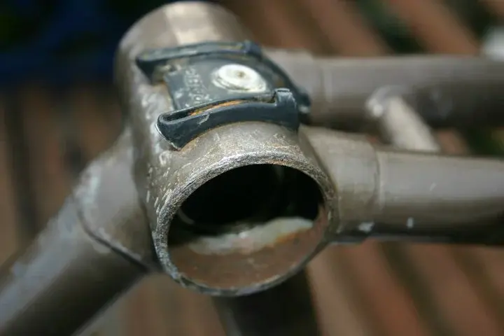

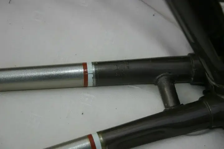

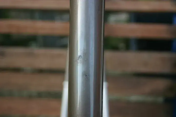

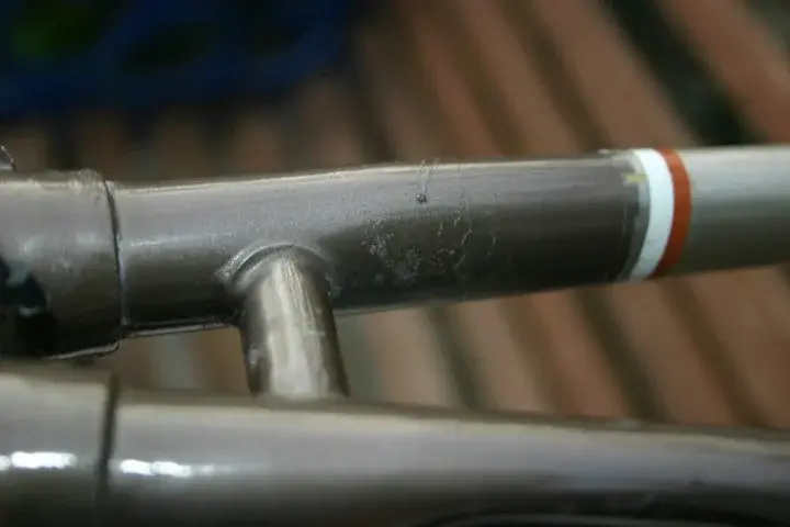

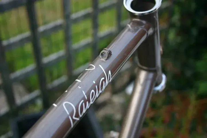

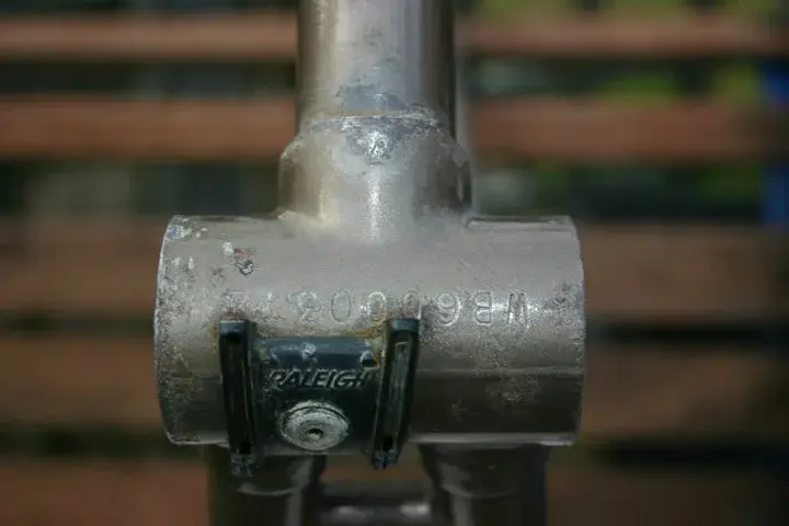

However, I was cleaning the frame up last night, the rust seems to be worse than I thought and it doesn't show on that picture. There are several patches of what I think is just surface rust, as the inside looks quite clean from what I can tell.
I've started to remove the rust with a bit of tin foil scrunched up, seems to work, it leaves quite a smear but then rub it over with metal polish and it clears up, but does leave a small black mark in its place, is this where the paint got chipped originally I wonder?
I did try some autosol, but it damaged the paintwork, thankfully on the underside of the downtube so wont be too noticeable, maybe I used too much.
Will post some close up pics later.
Rich
if you are using aluminium foil wad it up and use vinegar with it, that brings things up a charm... :wink: It's a lot less abrasive compared to autosol.
A couple of pics after my efforts to get the rust off. Think I'm going to leave it at that as it really should have a respray before it looks right, but I'm fairly happy with it for my first effort.
Moving onto the chrome next, I've autosol'd the cranks, pedals (couldn't get these off so have polished them in place :) ) and the brake calipers.
Will start on the rest of it when we get some clear weather.
