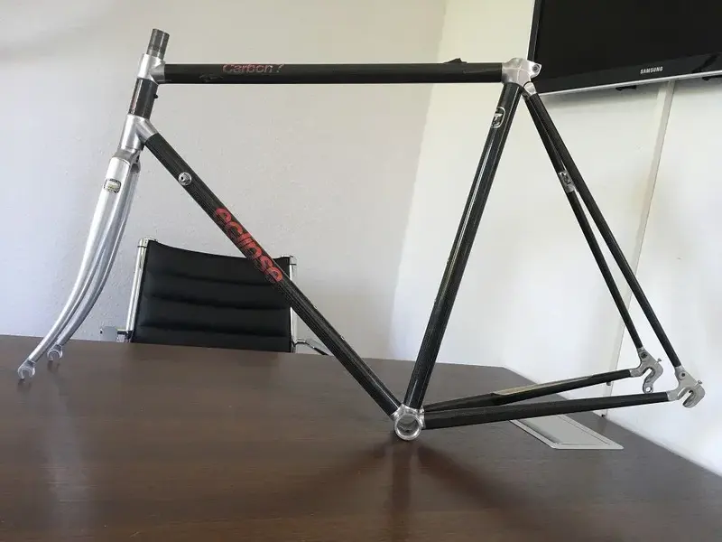

Dan you can also looking for a Eclipse Carbon 7 in the US like this
The TVT used by Team LaVie Claire was a 1st Gen TVT Carbon 7 presented in 1983.
Within US they sold it under Eclipse label ... sometimes you can find one ...
But more problem you will get to find a 1st Gen Corsa Record groupset - this was the version wiht the graved Shield Logo on crank and rear mech and a front mech which has been riveted in parallel ... I looked for them many many years
