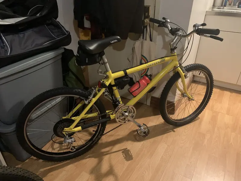

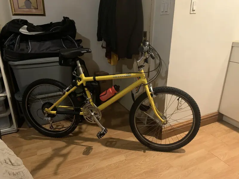

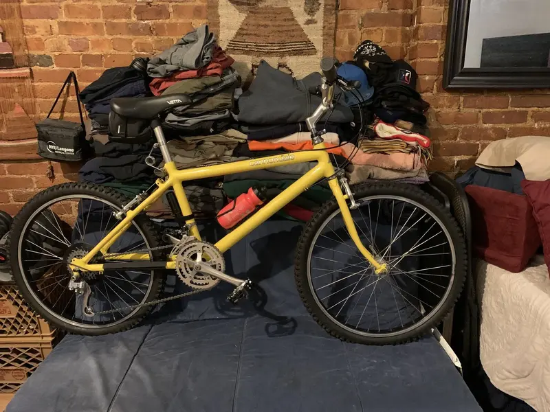

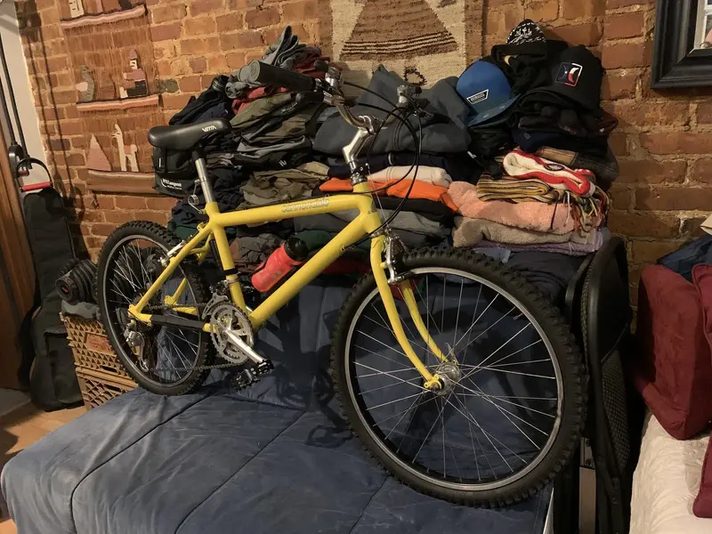

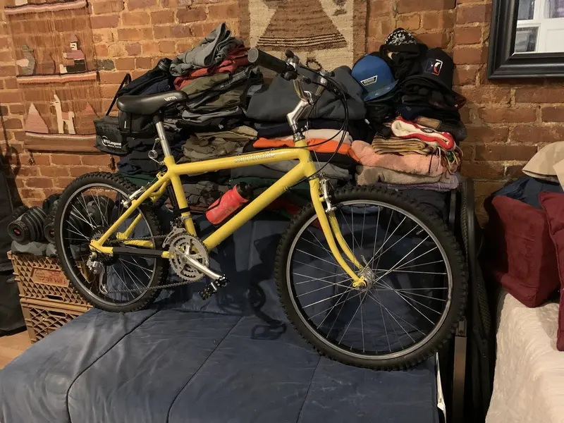

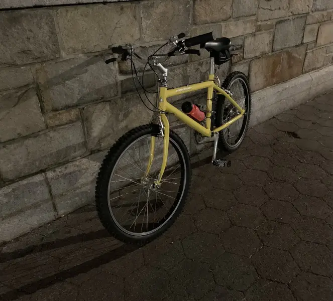

1986 Cannondale SM600 24x24
Finished up this morning before heading to work.
Just need to hook up the derailleur cables and tune!

Build Specs
Frame and Fork : 1986 Cannondale SM600 (Small 14” frame) fits 24”x 24” wheels only.
Handlebars : Nitto Riser
Stem : Suntour XC quill stem (70mm length)
Headset : Suntour XC
Headset brake cable hanger : Suntour XC
Brake Levers : Dia-Compe 282
Brakes : Suntour XC Pro Roller cams
Brake Pads : Kool Stop Eagle 2
Shifters : Suntor XC Power Ratchets
Rear Derailleur : Suntour XC Pro
Front Derailleur : Suntour XC Pro
Cranks : Sugino LP
Chainrings : Sugino ( 44, 36, 28 )
Bottom Bracket : Sugino
Pedals : Wellgo Bear Traps
Seatpost : Suntour XC Pro with Hite Rite
Seatpost Skewer : Suntour
Saddle : Vetta
Rims : Sun Cannondale 24”x 1.75”
Hubs : Suntour XC Pro (Sealed bearings)
Spokes : Stainless Steel (36 spokes, 4 cross lacing)
Freewheel Cassette : Suntour 5-speed 14-34t
Spoke Guard : Cannondale
Skewers : Suntour
Tires : Kenda Smoke-like (24 x 2.1)
Grips : Race Face Getta Grip (single lockon)
Water Bottle Cage : Avenier Aluminum
Frame Pump : MT. Zefal
Seatbag : Cannondale
Looks great, like an oversized BMX 👍
Thanks Tsundere!
I bought it tatty, but reasonably cheap (350 USD).
Came with most of the original parts.
Just needed to be cleaned up, add a few catalog correct parts and new decals from vintage cannondale.
Paint is even original, just had to touch up a few chip spots with paint I mixed myself.
Thanks Tsundere!

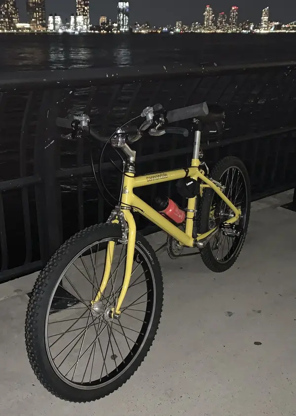

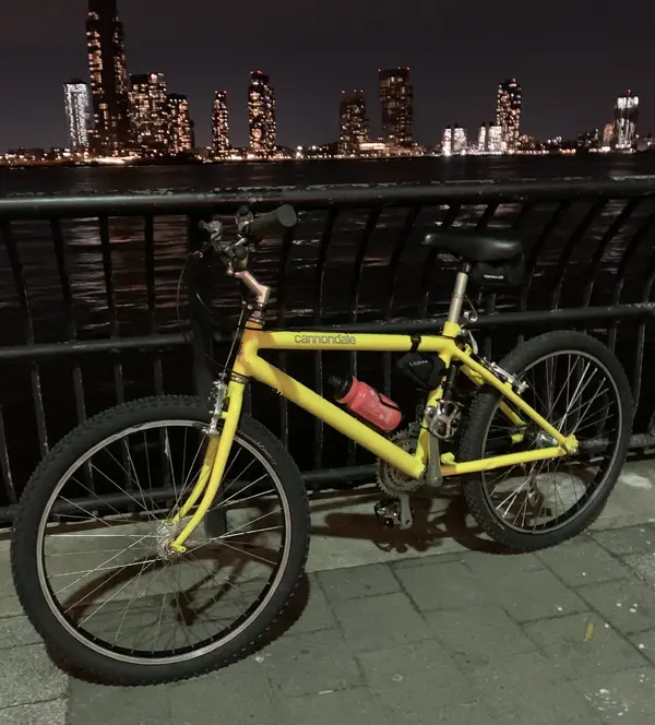

Finally adjusted and tuned!
Took it out for first ride.
Rides like a 24" wheel BMX cruiser.

Nice work on that: digging it in yellow.
Your red one is really cute. Do you plan on putting a front mech on that?
It has the original yellow paint. I just needed to touch up a few chips and put on new decals from vintage cannondale.
I bought it tatty and cheap as a mostly complete bike. Just needed a few parts to make it catalog spec.
