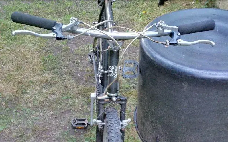

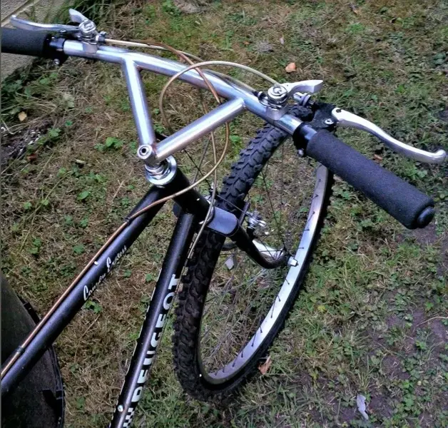

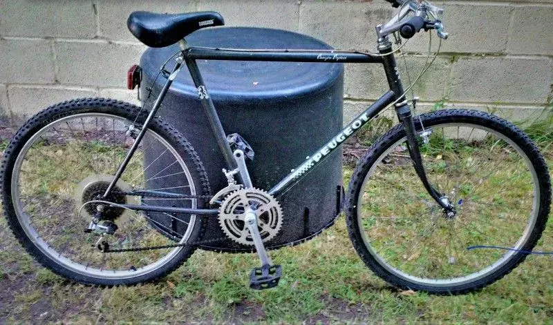

I'd been looking for a properly retro mtb for a while, and when I saw this I had to have it :twisted:
It is, I think, a 1984 or '85 (pretty sure now its an "85) Peugeot Canyon Express. I was drawn to the biplane fork and the bullmoose bars.
It has massive Dia-Compe brake levers and Suntour thumbies, the rear mech had been "updated" to a Shimano Exage Trail mech but I have now fitted the correct Suntour Alpine Gear mech.
Photos are from the seller
I've changed tyres to amberwalls, replaced cables and chain , and will also change pedals and saddle.
I'll update with recent pics in the coming weeks, but I think it should make a nice mtb to pootle around on :)

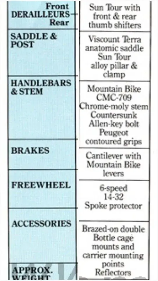

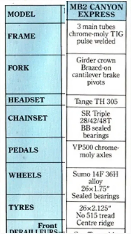

1985 Brochure pics...

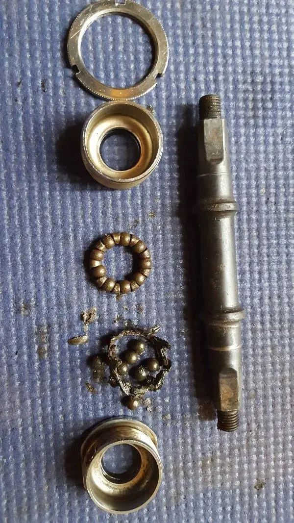

Hmmm..... no wonder there was some play in the Bottom bracket axle....

New bearings fitted to bottom bracket, still rumbles a bit, could probably do with renewing completely but it'll do for now.

I think I've pinned the bike down to a 1985 model.
At this time there were only two "Mountainbikes" in the Peugeot range (in the UK brochure at any rate), the "Urban Express" which was more city oriented, and the "Canyon Express" .
Another page from the '85 brochure (looks like the guy bottom left is wearing loafers! :shock: cycling style has changed a lot :lol: ).
