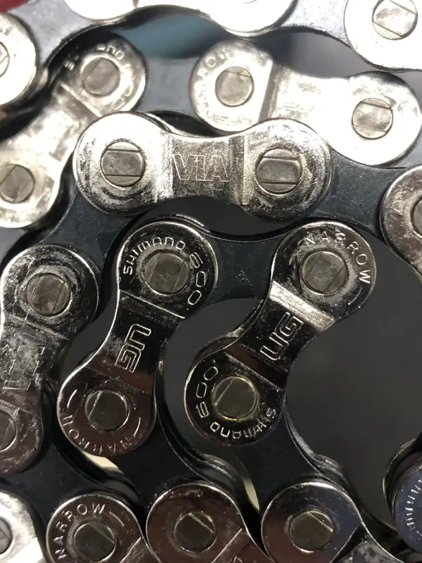

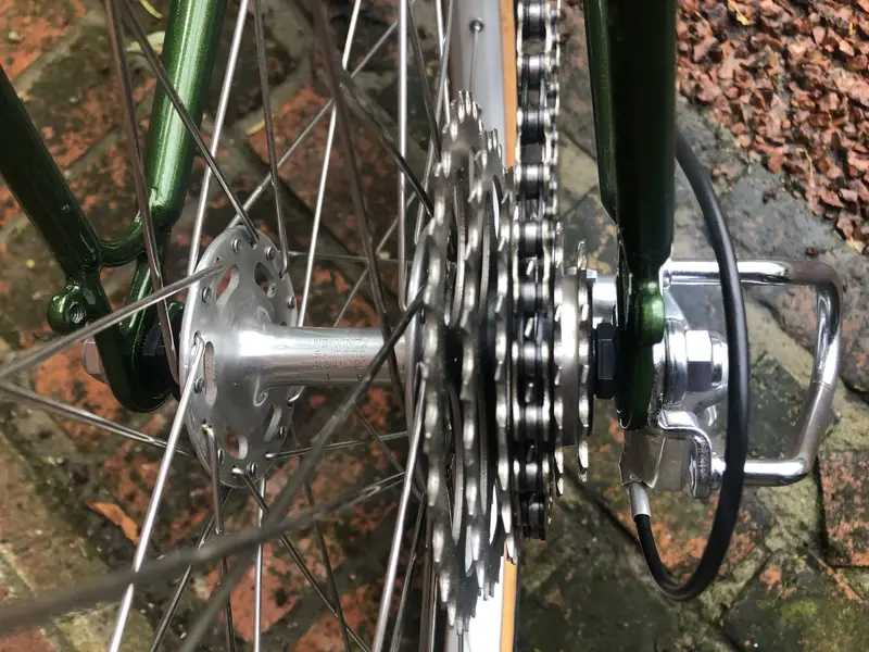

The afore mentioned EX600 uniglide chain turned out to be a UG50..... 🤦 ah well never mind, the search continues.
Best get on with polishing bolts I guess.... :| 861113A8-D27C-4944-A9D3-4A3DDFB6B491.jpeg

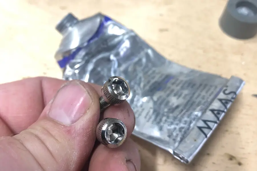

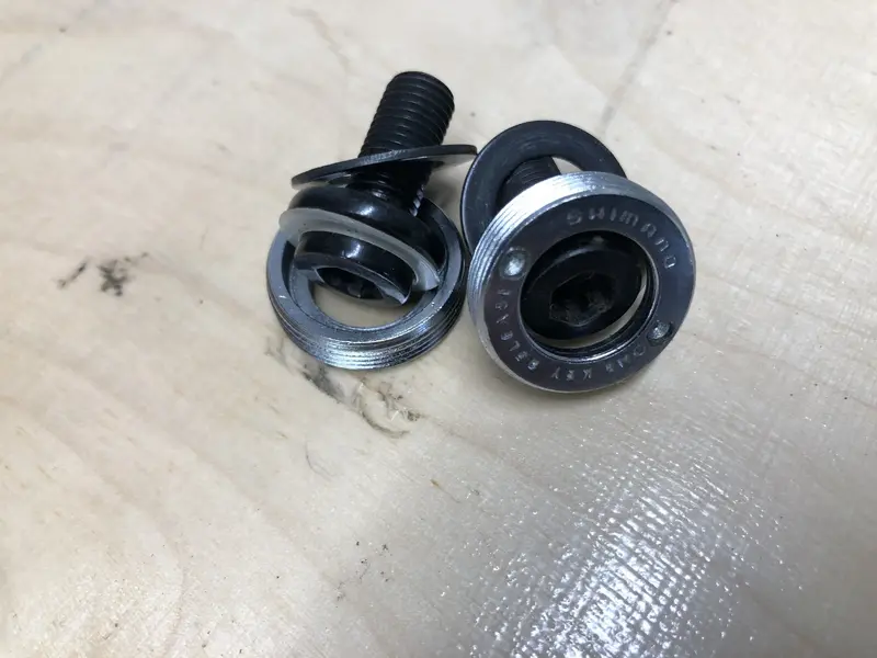

More shiny arrived today.... :cool:

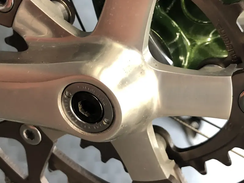

Does anyone know when these Shimano “one key” axle bolts first came out? :?: IMG_6267.jpg IMG_6265.jpg
Re: 1984 Claud Butler Canyon #H130008 Deore Deerhead XT & 600EX
looong time ago, I'm sure they were a DA or 600AX sort of thing. You'd need to trawl the catalogs

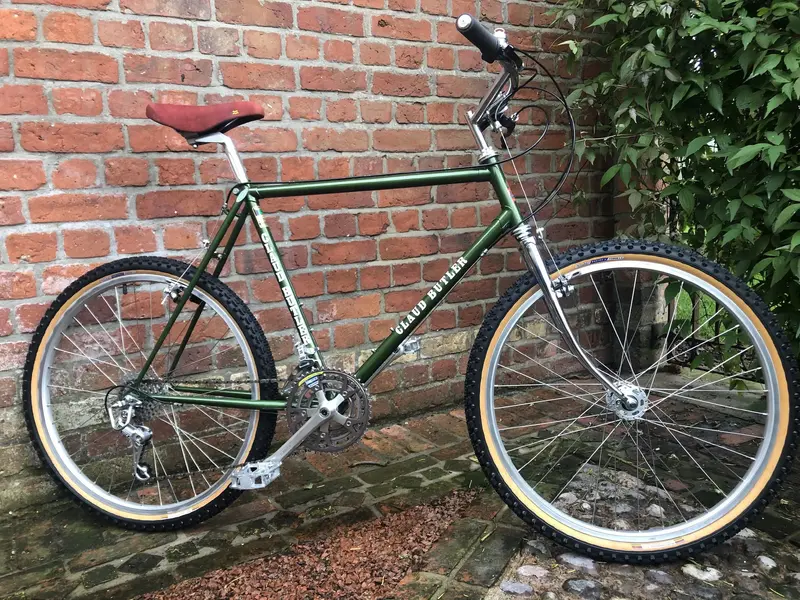

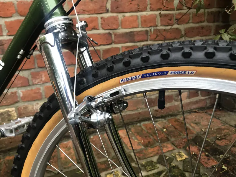

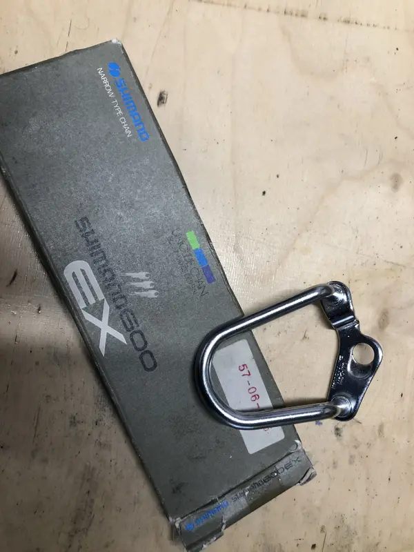

Last bits arrived to finish off the Canyon…
A couple of shiny items fresh out the box so no bloody cleaning required! :D
A Shimano 600EX CN-6208 116L Uniglide narrow chain & a Shimano SM-DG11 derailleur guard

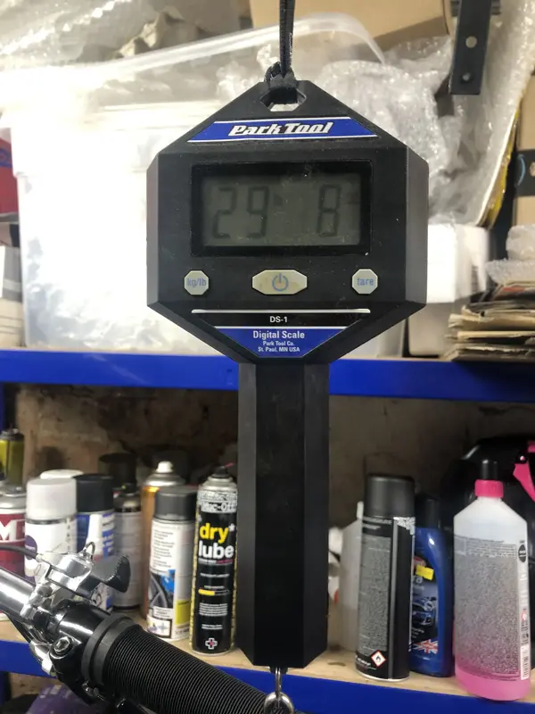

Final weigh-in…. a healthy 29lb 8oz… Daddy’s very proud of his new arrival. :LOL:
Spec sheet & photos to follow.. BTW you may have noticed that the catalogue went out the window.. well it was getting bloody tedious, so I decided to go down the route of full bling up-grade.
All the kit pretty much hits the spot date wise, ranging from 1983 to ’87, with perhaps the exception of the tyres & saddle (& of course the cables) IMG_6400.jpg IMG_6399.jpg IMG_6398.jpg

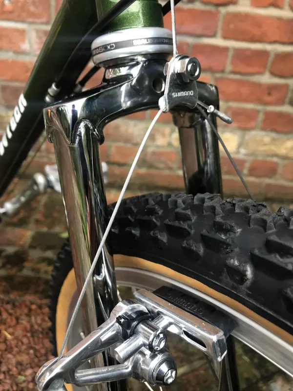

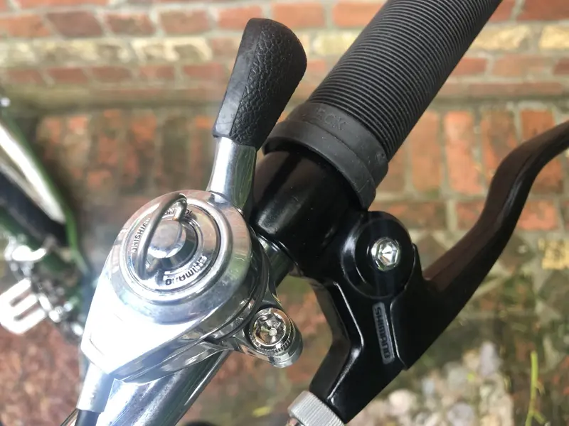

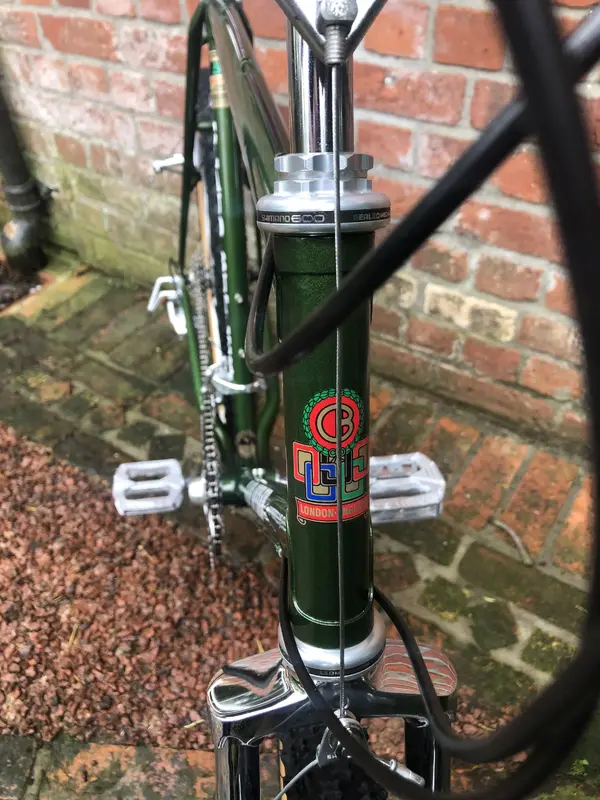

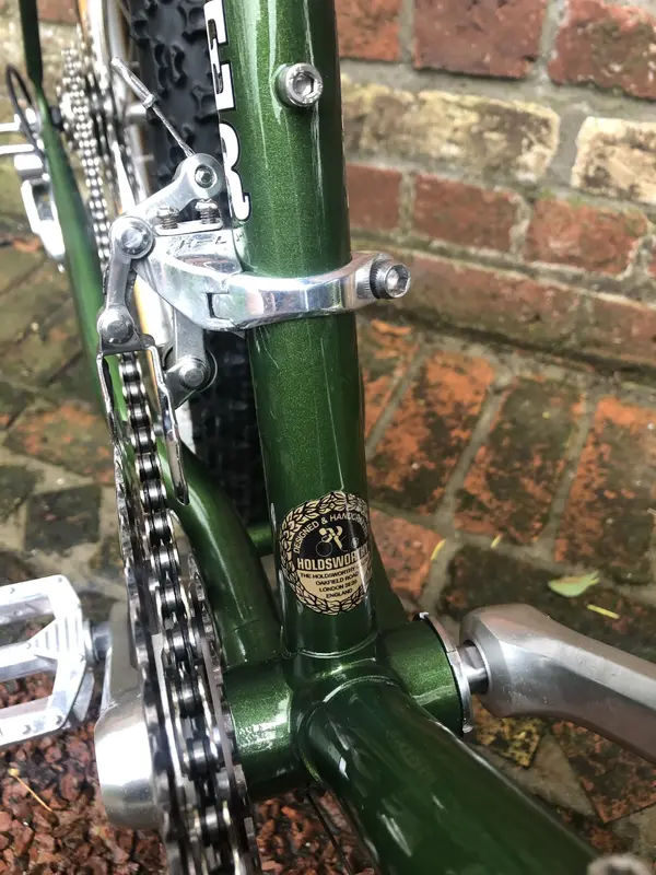

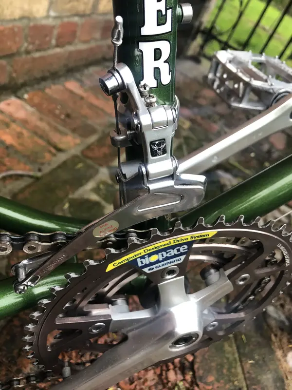

Specification for the Upgraded 1984 Claud Butler Canyon
Frame:
22” Claud Butler Canyon, Reynolds 531 All Terrain stays & butted tubes, Frame number H130008 (Nov 1984)
Fork: Reynolds 531 All Terrain, Chromed (matched number H13000:cool:
Headset: Shimano 600EX HP-6207 (Oct ’85) NOS
Handlebar: Nitto Cro-Mo “Bullmoose” integrated stem & hanger NOS
Grips: ODI World NOS
Bar ends: Nitto Aluminium caps EC-01 New
Brakes: Shimano Deore XT BR-MC70 cantilever, silver (June ’86) NOS
Brake Pads: Shimano NOS
Brake Cables: Shimano NOS
Levers: Shimano Deore XT BL-M700 (’83-’86) NOS
Shifters: Shimano Deore XT SL-M700 Uni-Shift (Oct ’85) VGC
Front Derailleur: Shimano Deore XT “Deer Head” FD-M700 Alpine (March ‘83) VGC
Rear Derailleur: Shimano Deore XT “Deer Head” RD-M700 (June ’85) NOS
Derailleur Cables: Shimano NEW
Derailleur Guard: Shimano SM-DG11 NOS
Freewheel: Shimano Deore XT MF-6208 6 speed - 14,16,20,24,28,32 (‘83) NOS
Chain: Shimano Shimano 600EX CN-6208 116L Uniglide narrow NOS
Cranks: Shimano Deore XT FC-6206 Biopace 175mm (March ‘86) Used
Chainrings: Shimano Biopace 48t, (June ’85) 38t, 28t (May ‘85) Used
Bottom Bracket: Shimano 600EX 68x124.5mm (Cups Dec’87, Axle Oct ’87) NOS
BB/Crank arm bolts: Shimano One Key VGC
Pedals: Shimano PD-MX15 Used
Rims: Rigida Rally 30* Used
Hubs: Shimano HB-MN72 silver high flange 130mm rear (may ’85) 100mm front (June ’85) VGC
Nipples: Brass/chrome plated New
Spokes: Sapim Stainless Steel New
Tyres: Ritchey Racing K force 1.9 (1986-1990?) VGC
Saddle: Specialized Lamda S red suede (’8:cool: VGC
Seatpost: SR MTE-100 (July ’87)* NOS
Seatpost Binder: Chromed steel Holdsworth** Used
Weight: 29lb 8oz / 13.4kg
* (’85 Catalogue correct)
** (Original to bike) Claud Butler Canyon (1).jpg Claud Butler Canyon (2).jpg Claud Butler Canyon (4).jpg Claud Butler Canyon (5).jpg Claud Butler Canyon (6).jpg

Re: 1984 Claud Butler Canyon Deore Deerhead XT & 600EX FINISHED
Lovely jubbly :cool: Hope you'll be entering it into bike of the month ;)
Corking build to be sure .... the green and silver compliment rather than compete against each other in the bling
Geometry wise it screams the 1980’s at you
