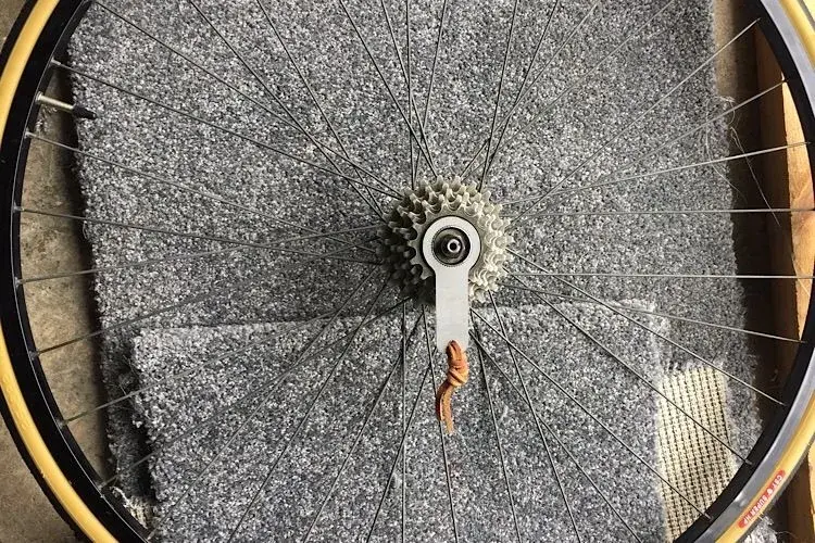

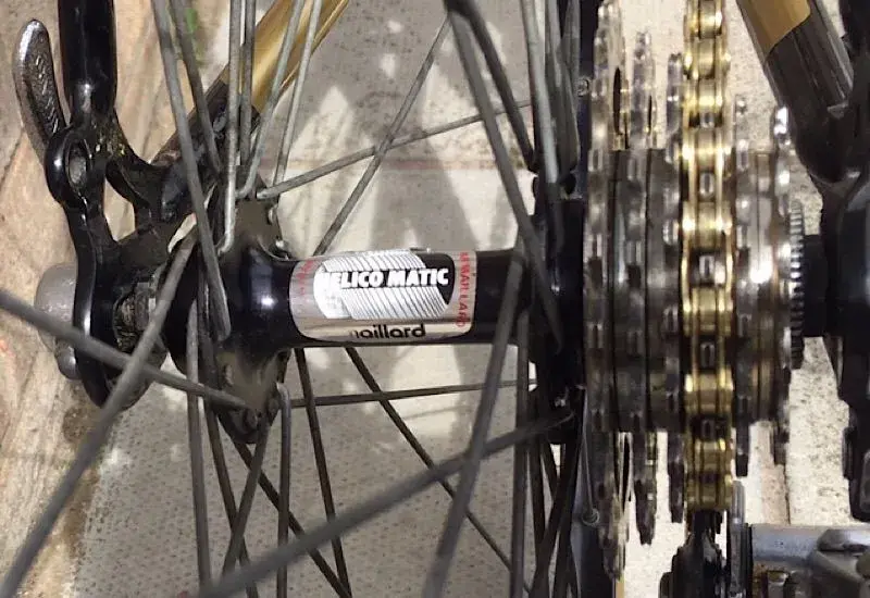

Bottom bracket was repacked today and the crank arms refitted with the help of my trusty rubber mallet and block of wood. The freewheel slid so easily onto the Helicromatic spline and was tightened using the locking tool which arrived from America last week.

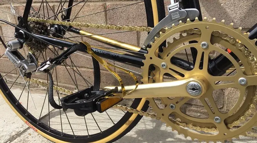

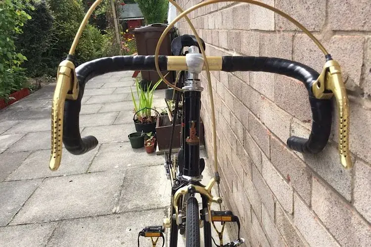

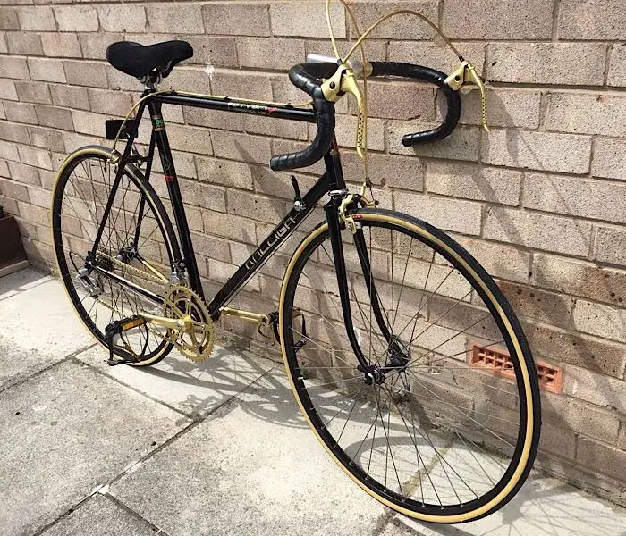

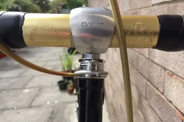

Finished the refurb this afternoon. It rides beautifully smooth even if a bit big for me at 23.5" this will be kept special. Hope to ride it at VR Ulverston next year, although I must get some serious hill training in before then.
Thanks for following this thread.

Very tidy.... does the neighbor want it back now? :facepalm:
Ps flip the seat clamp so it’s up inside the seat, that’ll get you an extra inch lower and look more tidy
