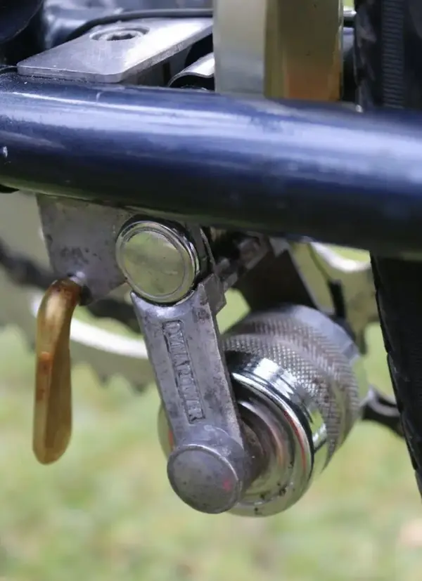

Had a fiddle today. Couldn't get the dynamo to work easily so took it off, together with some other tat.
Basically adjusted a few bits and doused everything in wd40. Rides OK now although chain sometimes still fails to mesh when shifting.
It's not fast but it is SMOoTH. Climbs surprisingly easily too.
What's the Blackburn plastic thingy I wonder? Seems familiar...

I am sure I had the chain miss the cogs and spin up if not absolutely precise with the lever. Its why I dumped all my crappy old stuff and stuck with indexed and ramped cassettes
Re: 1983 Claud Butler Majestic
Yeah, that's roughly what it's doing, although it goes into gear nicely more often than not. I've experienced it before, but also had plenty of smooth shifting non- indexed setups.
I think shortening the chain (and increasing mech spring tension) might help pull the chain down on to the cogs. Chain is way longer than it needs to be. Lubricating the mech has definitely helped and it should free up a bit more in use.
Fitting the older wider chains worked but it was still 'clank clank clank clank clunk'
