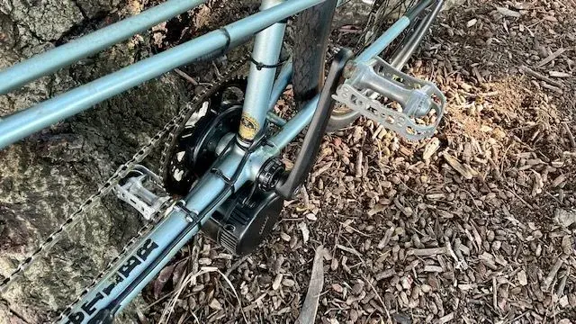

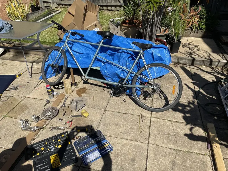

Turns out that contrary to most of the posts I’ve read there is not enough clearance on the left for the original gear ring so I’ve moved it to the right for the time being.
It’s a mess at the moment but the Bafang kit works a treat.
Anyone who thinks they need more than 500w as an assist is out of their minds. I’ve only dared going uphill so far (no time to fit brakes…) but this thing pulls away plenty fast enough with assist on 1 (out of 9).
More to come as I tidy it all up.

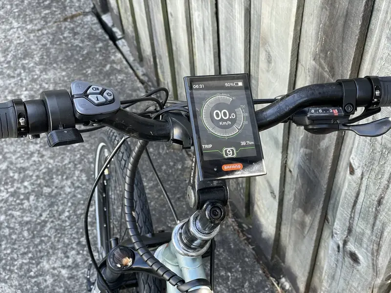

The kit I bought came with a kitchen sink—very comprehensive (including extension cables and brake levers with sensors built in), but no instructions at all. Apparently they’re online somewhere, but I found the few questions I had were answered by google/youtube.
I’m now looking at getting a mini-under-the-handlebar shifter to make up for the loss of the one that was integrated into my old brake lever.

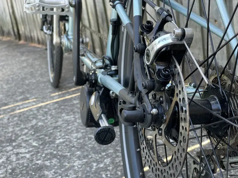

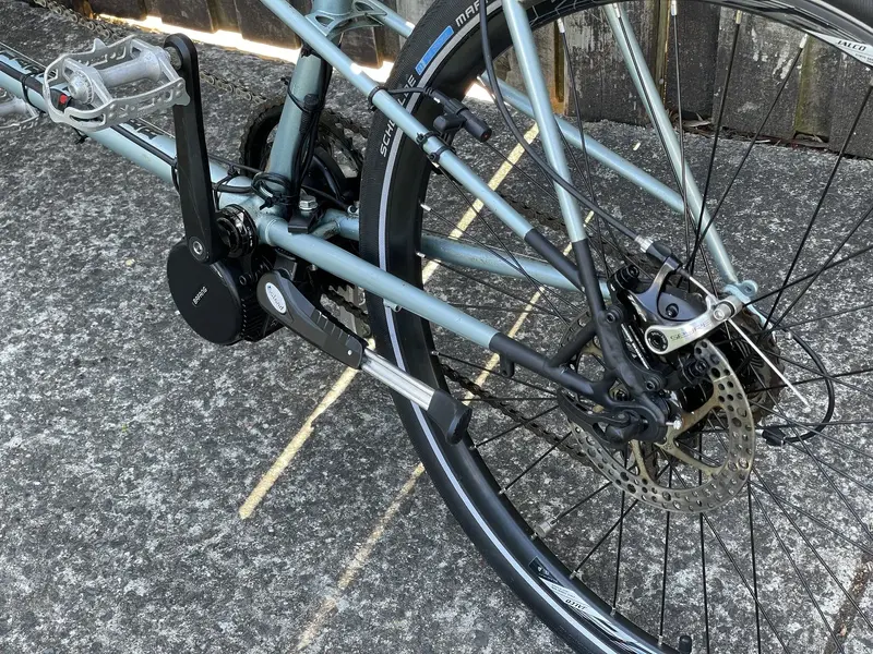

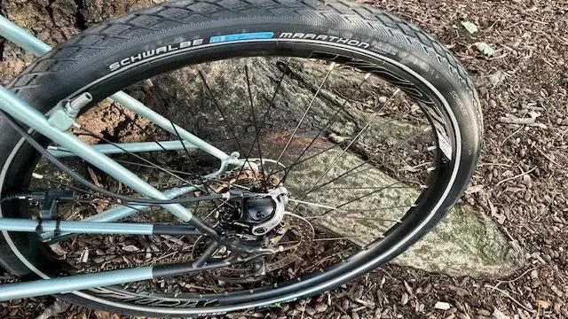

The disc came out of the blue Peachy!. I spoke with a local frame builder about repositioning the lugs (font and back) to suit the 26 inch wheels and took the bike down to his workshop so he could have a look. He said it wouldn't be difficult but he couldn't do it for a week or so due to other work (he also said his first bike was a Claud Butler!).
Then when I did take the bike down to have the work done he asked how I felt about a disc on the back. He said that rather than messing with the lugs at back he thought it would make more sense to strengthen the frame and mount a disc calliper.
I got the feeling it was a case of the lesser evil in terms of frame integrity.
I agreed as I had already bought wheels that happened to have rotor mounts, and I had an old rotor and calliper - though, as you can see from the photos I decided to make as good a job as possible and splashed out on a new calliper.
Once I'd finished fitting the new wheel and braking gear today I didn't have much time to bed the pads in. The manufacturer says it can take a while. After a short ride I could feel the pads starting to bite but I think there's a way to go yet.
To be honest, if it wasn't for the necessary change of wheel diameter I don't think I would have bothered with the disc conversion.

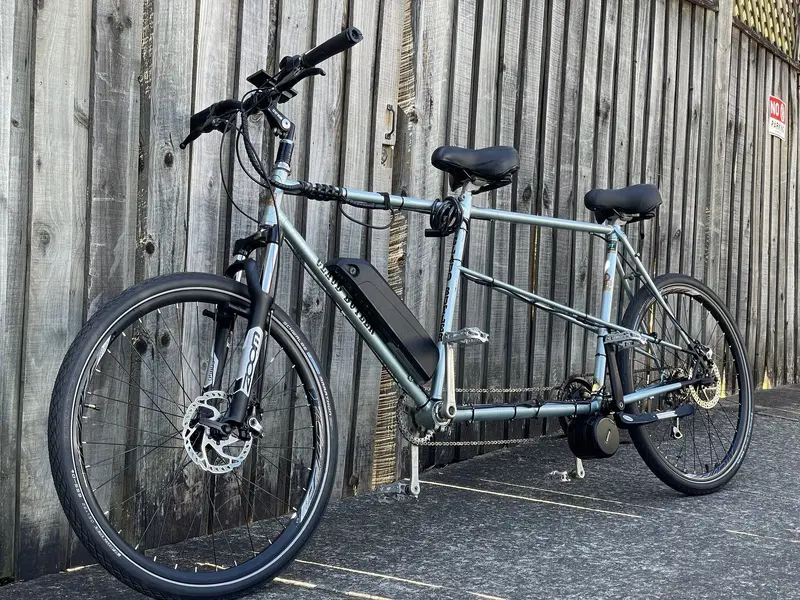

Having said that I am tossing up whether to go for the disc when I fit the suspension fork. It's a much easier job (lugs already there) but Sean (frame builder) said to consider the possibility of extra stress on the steerer tube.
Sean builds competition bikes for a living so I understand his point, but I'm not sure that under normal conditions there would be any extra braking stress at all.
At this point I'm open to all thoughts on the matter.
The only likely occasion for extra stress is if it “gets away from you” on a steep descent, fully loaded. If you take care this sort of incident should be almost nonexistent

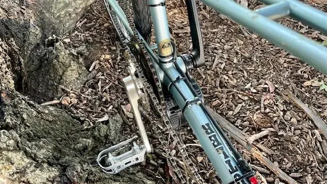

While waiting for the suspension forks to arrive in the mail my next job is to find a set of 140mm cranks - for extra clearance - and (hopefully) refit the front pair of chainrings back on the "right" (left) side of the frame.

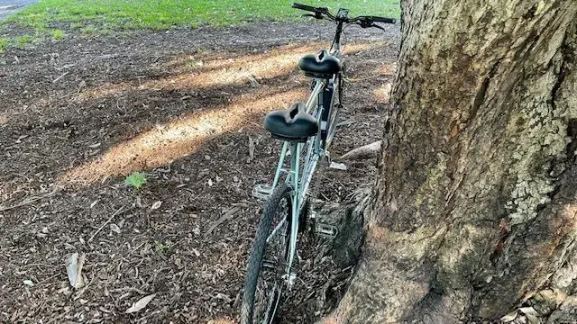

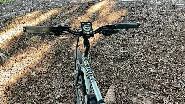

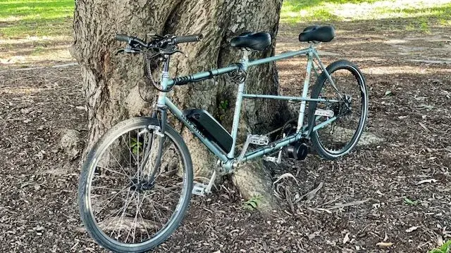

We’ll, it’s not “finished” by any stretch of the imagination, but it now has many of the bits I wanted fitted and operating more-or-less how I expected.
Will add more detail and answer any questions in the next day or so. Right now having too much fun.
