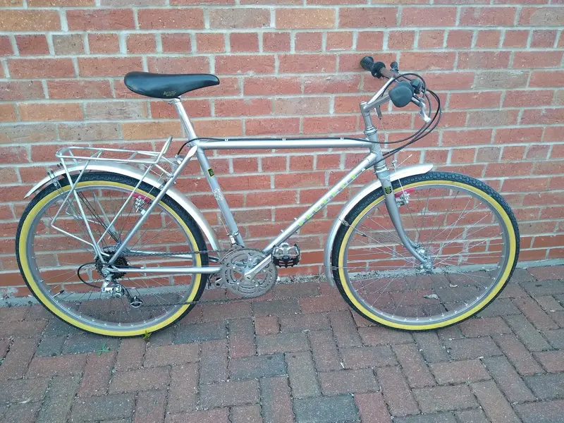

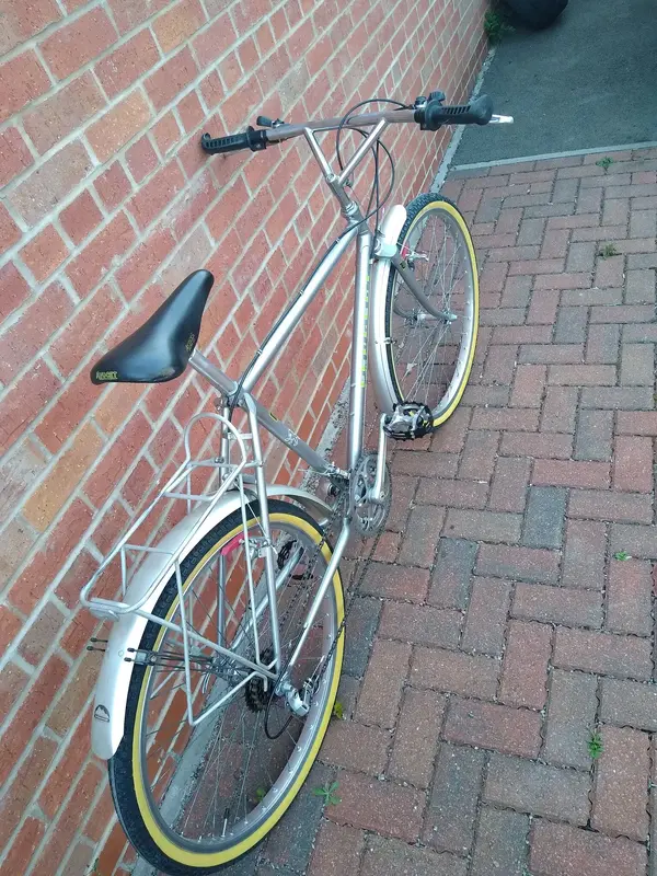

I was going to say it looks a bit naked without the guards and rack. If you can get the guards to fit properly then I think it would look great
By "popular" demand, here it is in full Adventure Spec. Can't guarantee the mudguards are period - but who has 1983 mudguards any more? And I know the rack isn't but it's nicer than the original which had horrid twisted steel brackets.
Would look great with a matching front rack :).
It is finished, if anything is ever finished.
yes agreed! it’s looking great though, fantastic job on refreshing this one.
I think it looks fine “naked” for summer use, and also fine with the guards and rack fitted.
I agree with the above, a chrome front rack (maybe a small Porter style one) would look good also (and it’s what all the cool kids on Instagram seem to be doing with their retro steel mtbs 😁).
By the way I bought some similar tyres for me 80’s mtb, seemed to be the only type that looked right and would fit in the chainstays.
Thanks gents. If the cool kids on Instamyspace are doing it then I want no part of it!
Seriously though I did look for front racks briefly but I can't find a raw aluminium one like the rear one. If I see one I'll bag it.
Need some giant Ever-Ready bike lights now!
