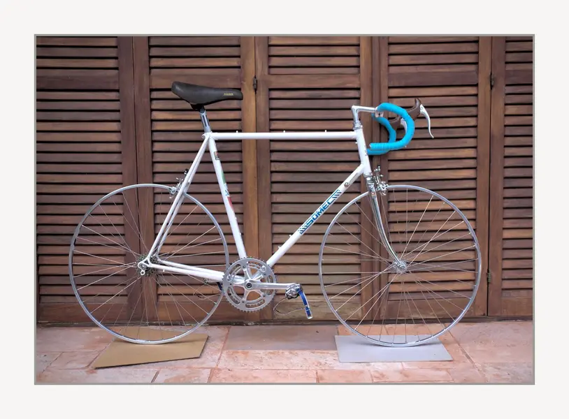

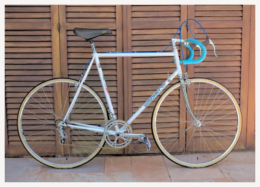

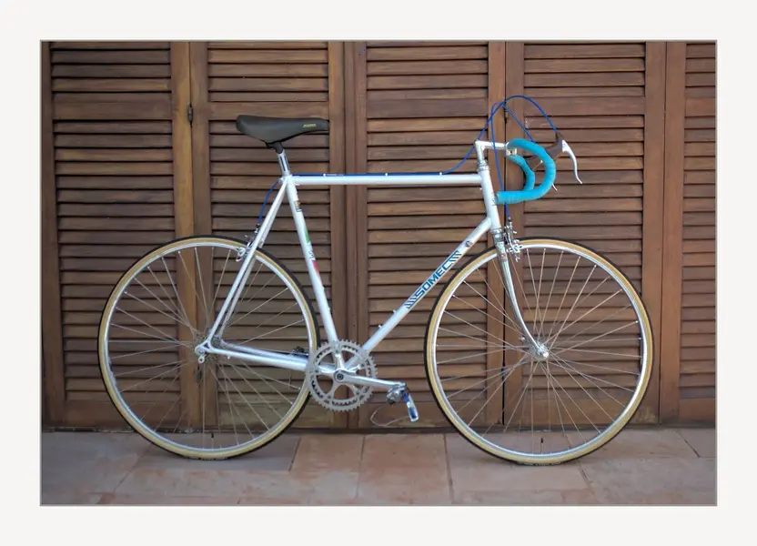

Edit: Now roadworthy - photos updated
Edit: Spec sheet

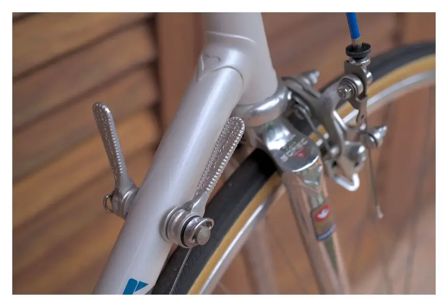

Frame: 1980s Somec Special size 59 - Gipiemme dropouts. Columbus Aelle tubing
Fork: Somec - Gipiemme dropouts
Headset: Gipiemme Strada
Stem: Cinelli 1a
Handlebar: Cinelli Campione del Mondo
Bar Tape: Cotton - no-name

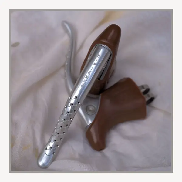

Brake Levers/Brifters: Gipiemme Crono Sprint drilled
Brake Calipers: Gipiemme Crono Sprint
Brake Pads: Gipiemme
Brake Cables: No-name stainless steel cables - Jagwire casing
Shifters: Campagnolo (type?)

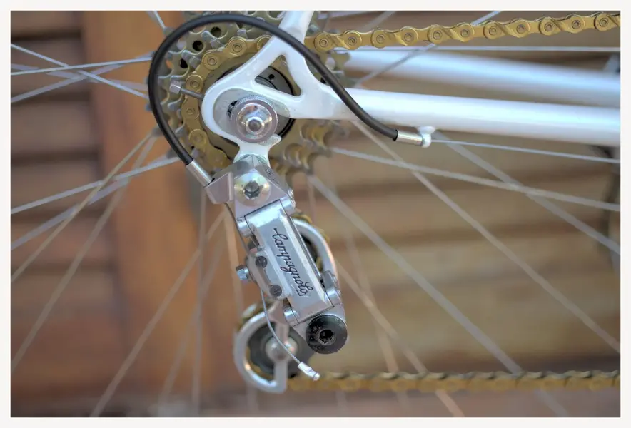

Front Derailleur: Campagnolo 980
Rear Derailleur: Campagnolo 980
Derailleur Cables: no-name stainless
Cassette: Regina Oro freewheel 14-24t 5s (should be 6s)
Chain: KMC X8 gold
Cranks: Gipiemme Crono Sprint
Chainrings: Gipiemme 52 & 42
Bottom Bracket: Gipiemme Strada
Pedals: Gipiemme sprint
Rims: Campagnolo Lambda Strada (tubular)
Hubs: Gipiemme Sprint
Hub Skewers: Gipiemme
Nipples:
Spokes: Stainless steel straight
Tyres: Vittoria Rally tubular
Tubes:

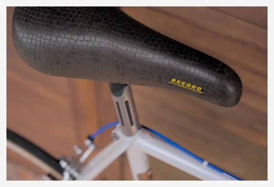

Saddle: Iscaselle Record World Champion
Seatpost: Selcof 27mm
Seatpost Binder:
Bottle Cage:
Extras: Zefal/Christophe toeclips/straps
Weight: 9.5kg (21lbs) without pedals
