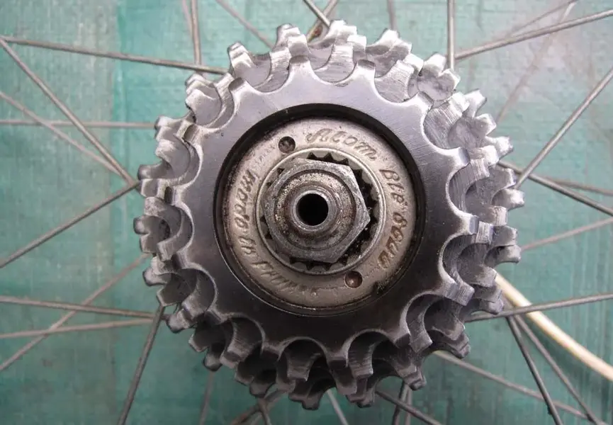

It has charm.
It has character.
look forward to seeing it finished and all the chrome and alloy cleaned.

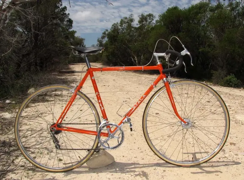

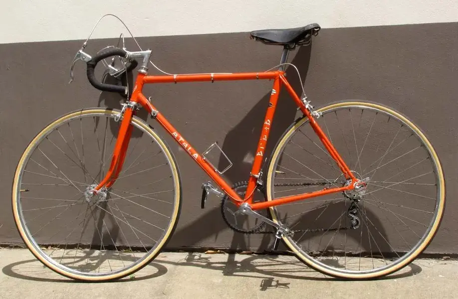

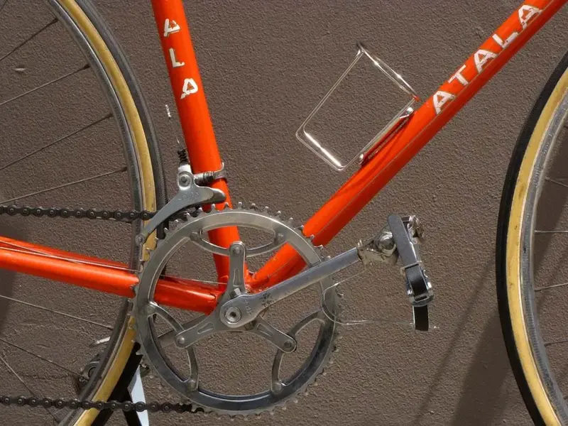

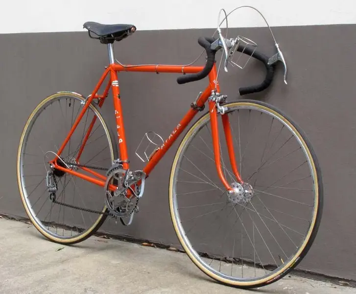

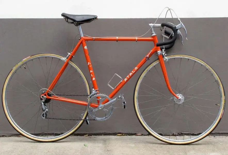

Finally completed the bike. I hadn't tightened the rear brake cable clamp on the frame properly and in the pics it's abit sideways. Sorry for my lack of attention as I was trying take the pics as quick as possible to get out of the sun - opposite to UK here (too hot!!!). Finishing touches included Velo Orange bottle cages, stainless brake/gear outer cables and bottle bar clamp, Vittoria wider sized 25 Rally tubulars and Cateye black cloth bar tape.

Great looking bike. The only thing I would do is swap out that old steel crankset for something a little lighter, but otherwise I love it.
