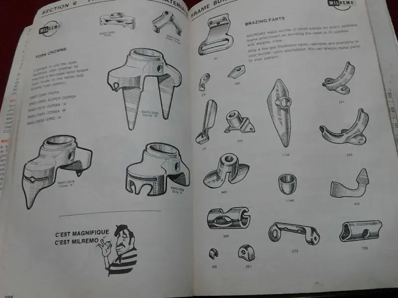

1963 King of Mercia - is it?
From the 1970 handbook.

So is the fork crown in question- i.e. the one on LGF's frame- a French manufacture? bduc61, have you seen that crown used on period (60s-70s) French frames at all? I don't remember seeing it, but obviously you have had far greater exposure. I notice that it is not used on the green Bertin C34 at your link, just above the post about Bertin/Kitching?
I extrapolate that Spanish Zeus stuff- whether 'Milremo-ised' or not- was more prevalent/generally available in France than in Britain. The Milremo/Arius saddle was made in Spain too, of course..

Presume you've checked the other usual stuff- established that this frame has 'English' BB threading and takes a 27.2 seat post? The Italian/French thing is sort of on-topic anyway, since, if this frame is a '63 it is pretty early in the English 'Italia' vogue- which displaced the baroque (French) Nervex lugs in favour of the simple pointed Prugnats. The Prugnats are French too, of course, but closely modelled on the sort of shape featured on late '50s Bianchis and Cinellis and such..
At least, thanks to jm we now know that the fork crown is a Milremo 'Giro', (another invocation of Italia) although still in the dark as to who actually manufactured it.
