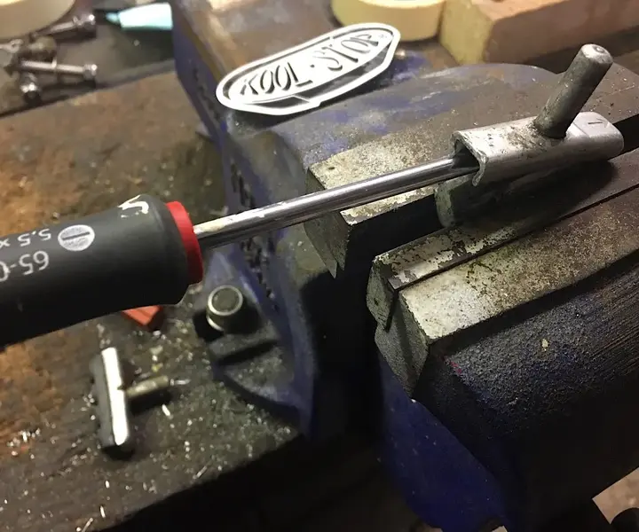

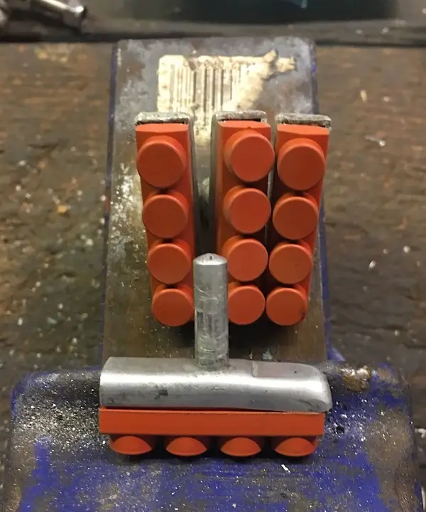

Salmon coloured 4 spot Mafac repro’s from Koolstop arrived today, beautiful.
Quick guide to swapping them out if anyone out there is interested;
1. Hold the old pads in a vice and gently ease off the aluminium holder with a small screwdriver.
2. Next push the new pad into the holder, this might only go in a few mm.
3. Whilst supporting both the pad and holder between thumb & forefinger, slowly & carefully close up your vice.
4. Easy peasy! 8)

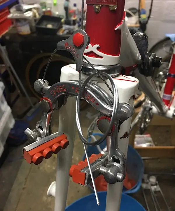

Brakes mounted, cables run, can’t do anything else other than tidy my tools whilst I wait for the wheels..... :cry:
