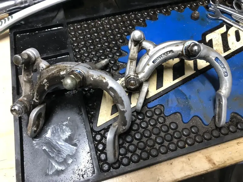

Back to the bike, the Campagnolo brakes wouldn’t fit (more a problem with the Allen key socket fitting than the reach) but after a dig through the boxes we found a set of Universal Super 68 brakes, they’ll do job perfectly, after a scrub & polish...

Finally got around to polishing up the Supers for the Super....they came up Super! :xmas-big-grin: IMG_8929.webp

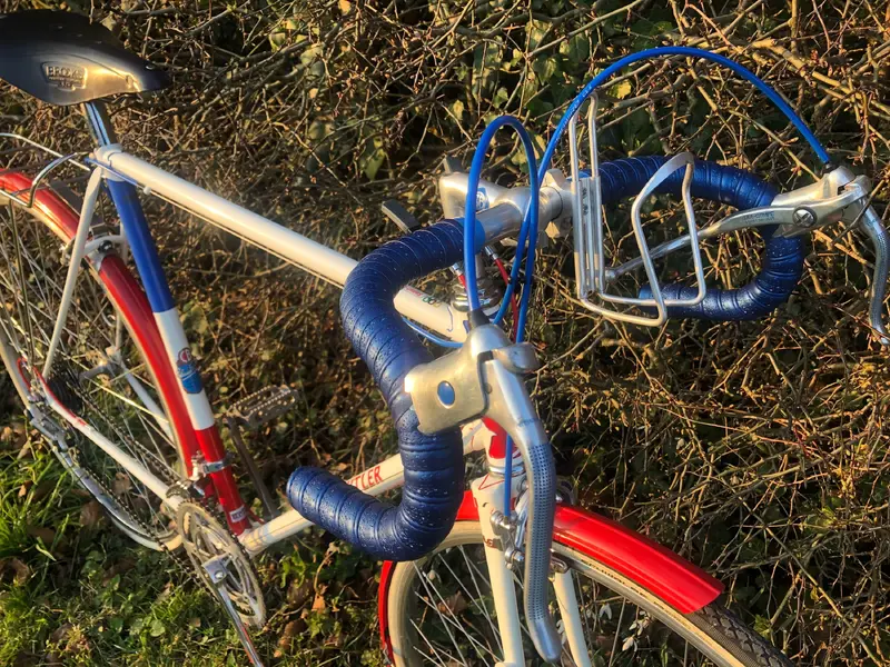

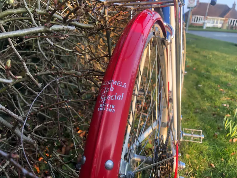

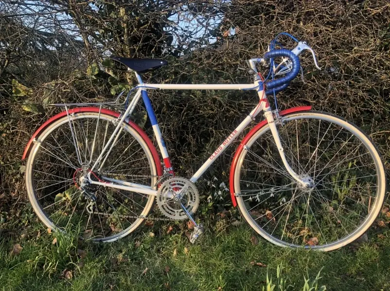

Finally got around to building the Super back up, now with the upgraded “Super 68” brakes with modern pads, a freshly refurbished set of lightweight Bluemels Club Special mudguards and some NOS early 90’s SIS kit the lad can now get back on the road, first short test had him beaming :D D3D2CF7C-E8AC-499F-A420-77A49D3FC927.webp 1E7FE877-F514-4665-9C99-155C06DB49B0.webp 10F13F65-1A81-49B7-BC19-CB35329C6356.webp AF740B68-D65B-4520-8F39-76404A371A65.webp 00878AA0-F6F9-4C2A-8F60-F157589BDF2F.webp
That is really smart looking and such detail. All the little fine detail really tie it all together.
Just lovely, one of the nicest builds I have seen for a while.

Cheers Jamie, pretty much all the predominately French 60’s running gear I originally built it with has gone (except the BB & crankset because that fitted perfectly) now a mix of 70’s, 80’s & 90’s, but more focused on practically & safety.
The Wolber Super champions take a more modern K-guard higher pressure touring tyre and provide a much improved braking surface for the more modern pads, coupled with the more powerful Super 8 callipers.
The 6 speed with climbing ring and SIS indexing work very well without ruining the aesthetic (I think)
And the Bluemels & kit carrying rack give us a bigger riding window.
Oh you might have noticed he insisted on his “suicide” touring levers brought over from his Cavalier! :roll:

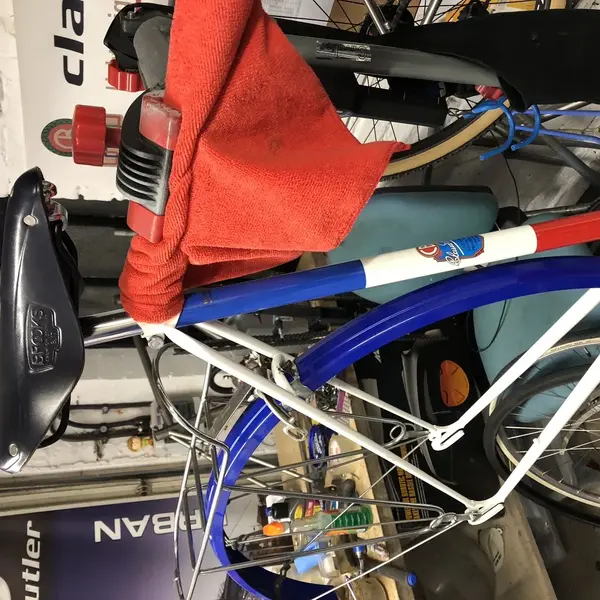

Cheers Allen, just need to re-fit the rack mount onto the other side of the brake bridge to flatten it out...
I do hate a sloppy rack! :shock:
