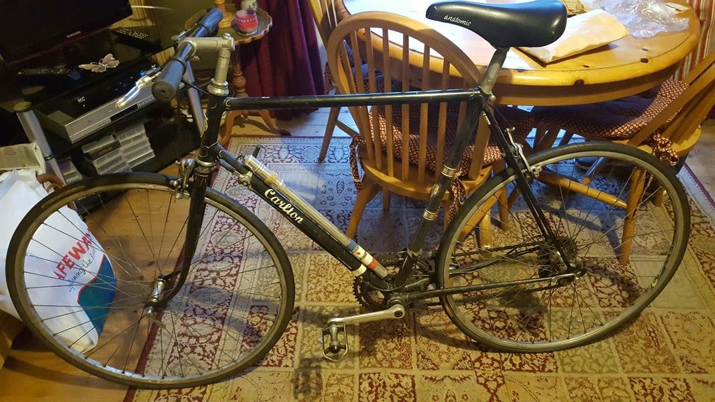

Ebay is still good for parts and you can get good prices for stuff. Bike jumbles and even gumtree. You can get fixed and free hubs so the best of both. Hopefully you can keep it original. Pictures always help.

Very nice :)
Just as an aside, I came across a lot of Carlton's like this in the 70's that had been added to over the years with new brakes, gears, etc. If you have problems getting original 50's kit then it wouldn't look out of place with late 60's early 70's equipment. :)
