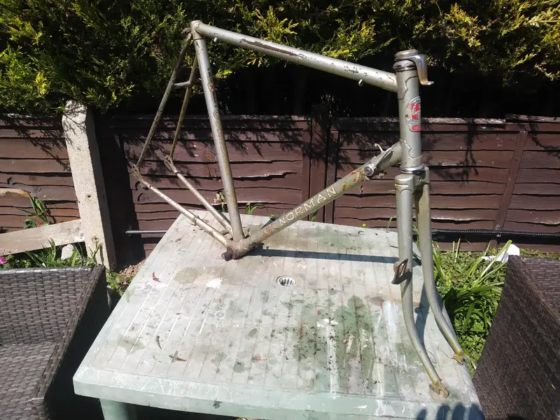

Hi Guys,
I have what I believe to be a late 1950s Norman Conquest frameset. I bought this as it stands at a car boot sale when I was 16 and 13 years later the build is still un-started. It came to me with the D/T shifter and some campag cable clips.
I have kept it all this time as it is a good size for me, was built locally and I like the novelty of its 'historical significance', being a history buff. About 5 years ago I managed to buy two NOS front wheel nuts which match the head badge but have done nothing more to start the build.
I have decided that:
- I want to get the original decals re-produced. Does anyone know a company that could do this.
- I want to get the bike painted Flam. Green. Probably by Don and his team at Jackson's
- I am going to build it as a flat-bar 1950s/60s 27in 'Touriste' bike, The hybrid of its day. I am looking for a set of GB All-rounder bars and GB Riviera brakes if anyone has anything lurking?
However, as the rear spacing is currently 115mm I am torn between:
A) Sturmey-Archer Hub Gear build
B) Having the rear end set at 120 and building it as a 5 speed with a Gran Sport as a previous owner did.
Stay safe everyone!

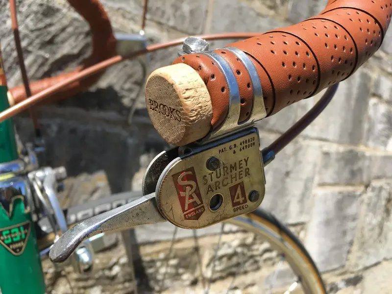

4 speed Sturmey... those old Campagnolo mechs aren’t quite as sweet as the later 70’s + versions.

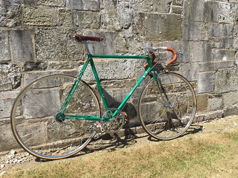

And you won’t be disappointed with BJ’s flamboyant green!

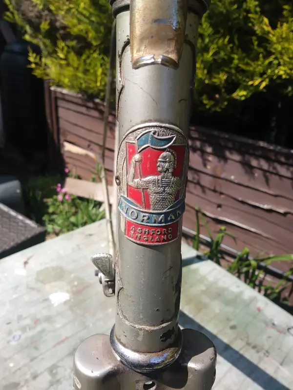

Its clearly from before Norman were badged raleigh. But the D to round fork blades look a bit low rent. Probably had a "Bendylux" before GS gear.
Is it possibly a Phillips frame?
iIt appears to have a 24 TPI bottom bracket and headset.
Sturmey Archer was never an option for me, saw too many in the 50s full of brown mud, where water enters through the ball race behind the cog.
Keith
