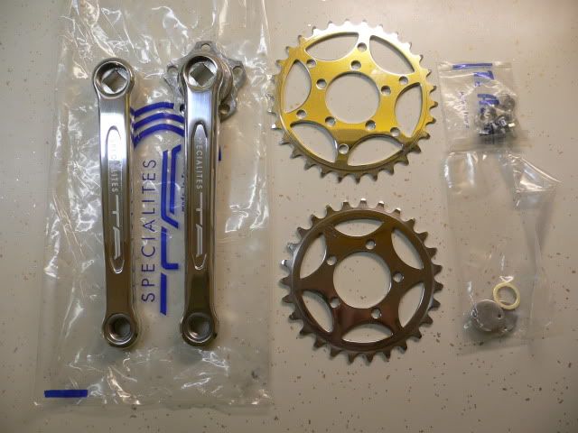

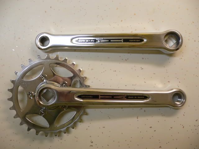

The TA's finally arrived from Spa Cycles. New 175mm Anniversary set.
I also got an older 27T ring from them and had previously ordered a 30T from RoBa Bikeparts in Germany. I think I'll start with the 27T given the gear ratios in the SA 8-speed hub.
As received:
With retro stickers:

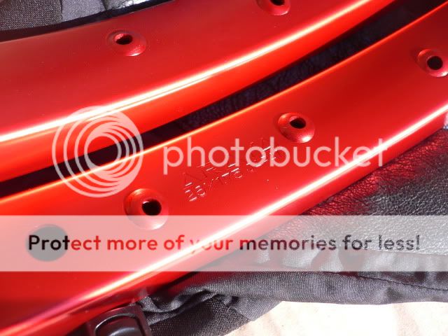

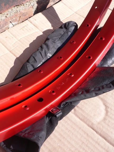

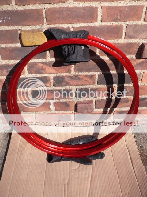

I decided to save up and get my Araya 7C's stripped and re-anodized in red to match the pedals... and maybe red pin-stripes on the frame someday... I haven't fully settled on that decision yet.
