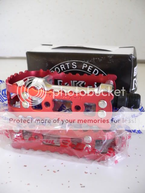

- NOS MKS BMX-7 pedals

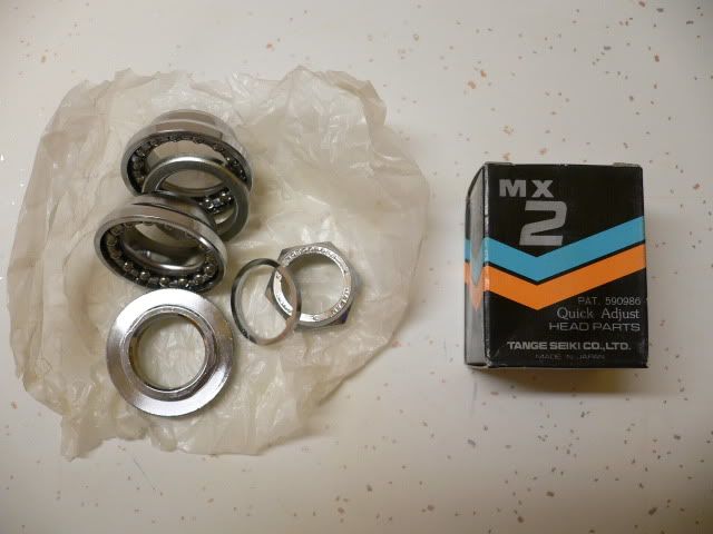

I found a NOS Tange MX-2 headset.
Looks to be much nicer quality than the Tioga MX-2 copy I used on the Fleet klunker.

Have you tried fitting that headset yet? Does it all look good. I appreciate it when you do my homework for me. Still need to find a headset for the "C" build.
Hey T,
Yes, the standard BMX headset with the 32.7mm cup outside diameter is what you want.
