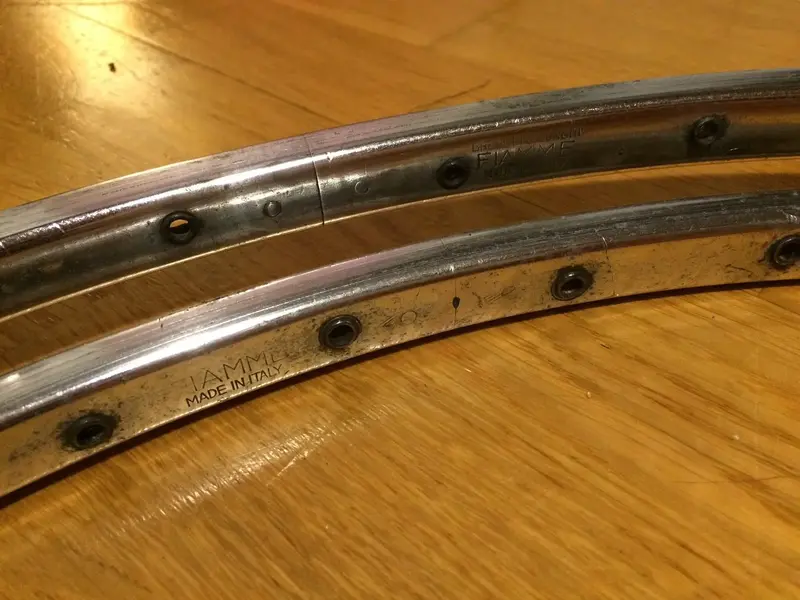

I've picked up some late 50s Fiamme sprint rims which were on early quick release Campagnolo hubs. They look exactly like the earlier ones apart from the Fiamme logo so they'll do for now. Stripped down and disassembled, hubs rebuilt. Pics to follow later...
Re: 1937 Parkes Lightweight

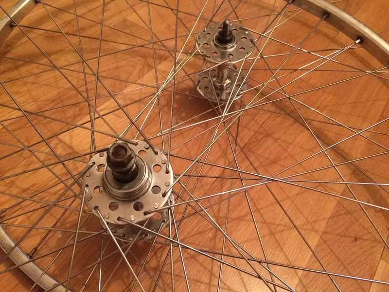

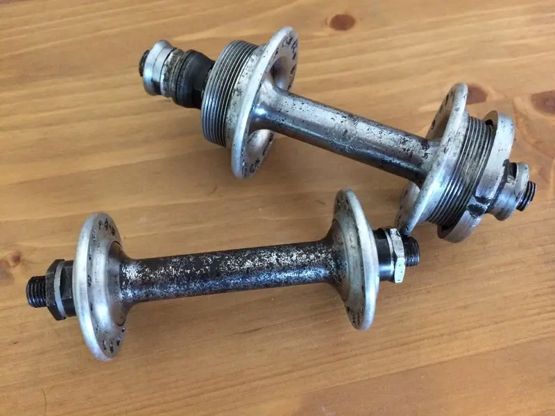

Finally a bit of movement towards a set of wheels. For the sprints I was holding out for something early, maybe a Sheeren to match the rear one I've already got, but I haven't seen a lot turn up. I've settled on these late 50s Fiamme rims which I bought as a wheelset laced onto these very nice early Campagnolo fixed/free hubs.

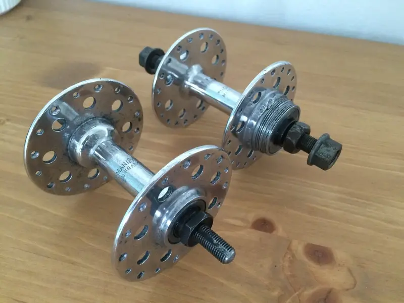

I'm not going to use these Campag hubs because I wanted high flange, these won't go on the dropouts because they're quick-release and also I'm not sure if I'm ready to take a drill to them because they'll only currently accept the older thinner gauge spokes. So I'm going to lace them onto the Normandy hubs, stainless double-butted spokes and I'm guessing 4-cross at the back and 3-cross at the front.

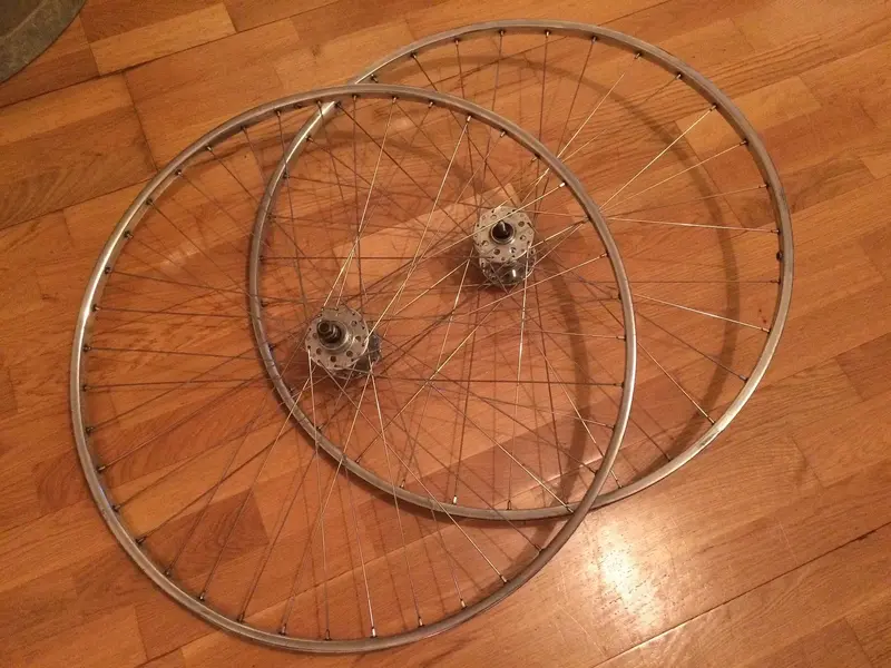

I've laced up the wheels. First time I've done a 4-cross spoke pattern so I was quite surprised to get it correct first time!
Front wheel weighs 760g, rear weighs 930g. Not too shabby!
