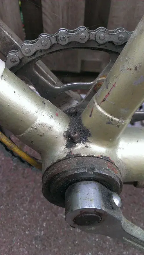

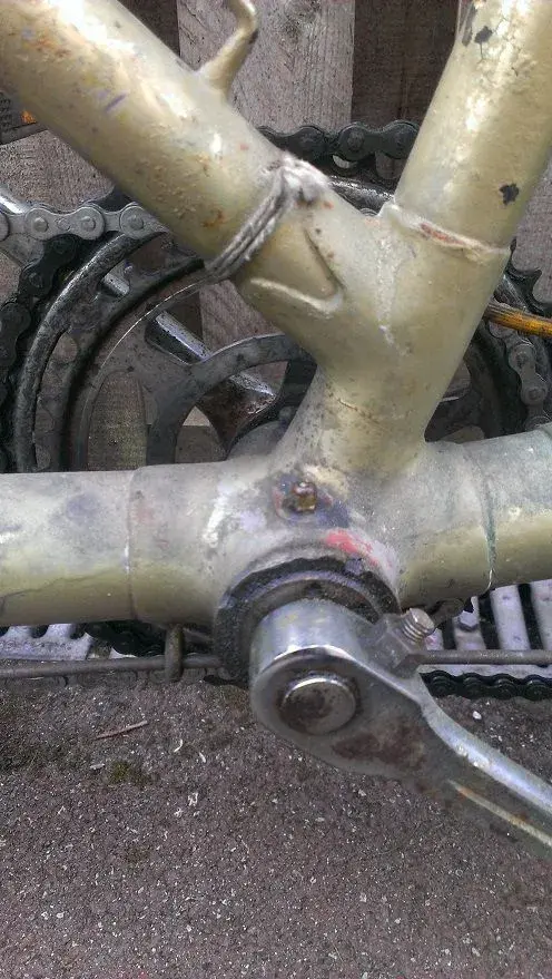

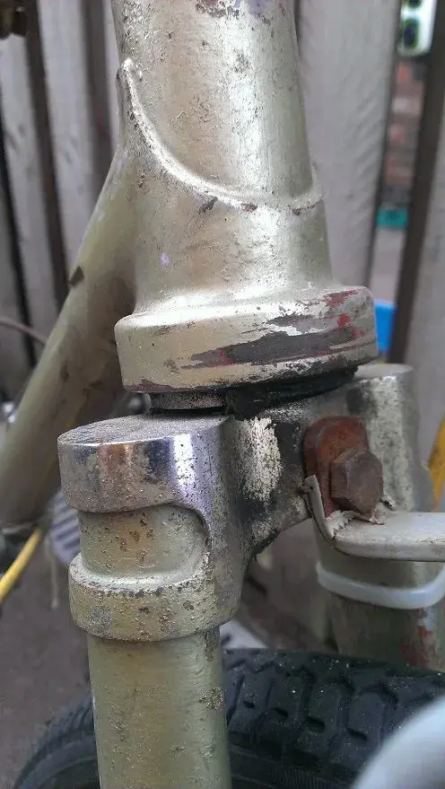

> Is it Brampton or Chater lugs and fittings?
How would I know the difference between the two? The lugs on the Grubb are fairly utilitarian - no fancy scalloped shapes - however the bottom bracket do have grease ports. I know Grubb was rather proud of his "patented grease injection system" in some of his literature. I've attached a couple of lug images. I had a search through Google images and can be swayed either way. Did Brampton or Charter have a distinguishing feature which I can look out for or is it material selection based?
