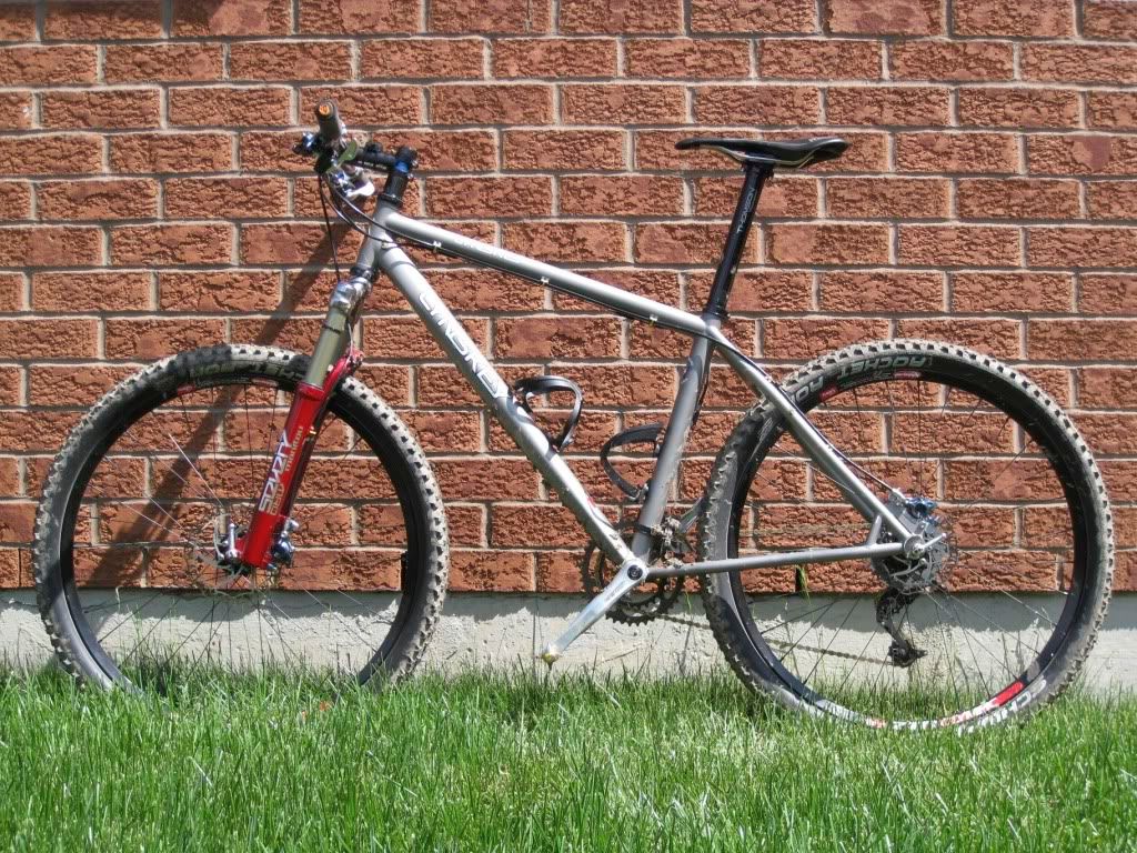

17lbs Lynskey Titanium Hardtail... finished
The wheelset is my fav part 8)
Is there a rider weight limit on them though due to the lightness,im around 96kg so would probably bend them ?
Ive go the DTswiss bladed spokes on my wheels,do you find that small crosswinds take you sideways,hehe
Magnificent obsession!
You have created a work of art.
Next time you're bringing it to the Don trails PM me, I'd love to see it in the flesh.
that looks fab 8) just that hint of purple makes it better,and 17lbs is very impressive
very impressive indeed

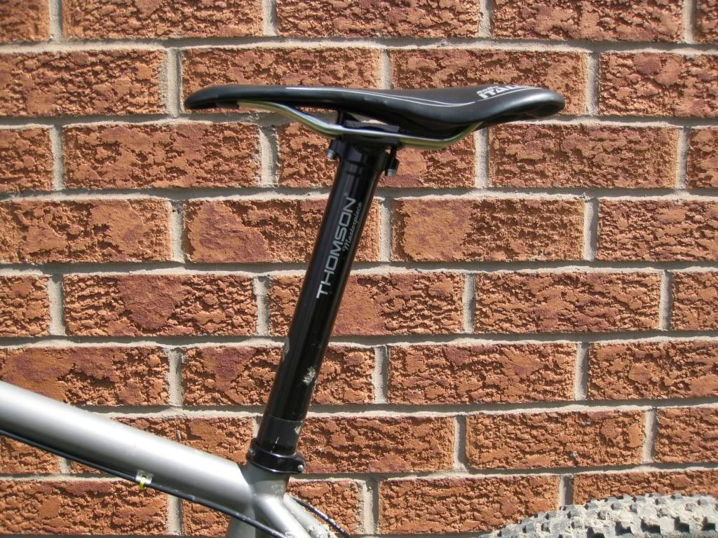

As for my bike. I had to make some changes to it since its first inception. I had to ditch the Easton EC90 Seatpost. The metal insert that is bonded to the top carbon clamp seperated. Once this happend there was no clamping pressure for the bolt to hold the upper and lower clamps to the seatpost head. THe saddle could not be sat on. I repaired this by cleaning off all the old epoxy and using Hysol 934A structural aerospace epoxy. This fixed that problem fine. It held the required 100 in-lbs of torque required by Easton. But the seatpost head has ridges that prevent the saddle from rocking back and forth in angle. This ridges were not deep enough. So what happens is that if you hit a bump the saddle would change angles. POS! I thew the seatpost into the garbage (I bought it NOS off of ebay). Then I picked up a Thomson Masterpiece.

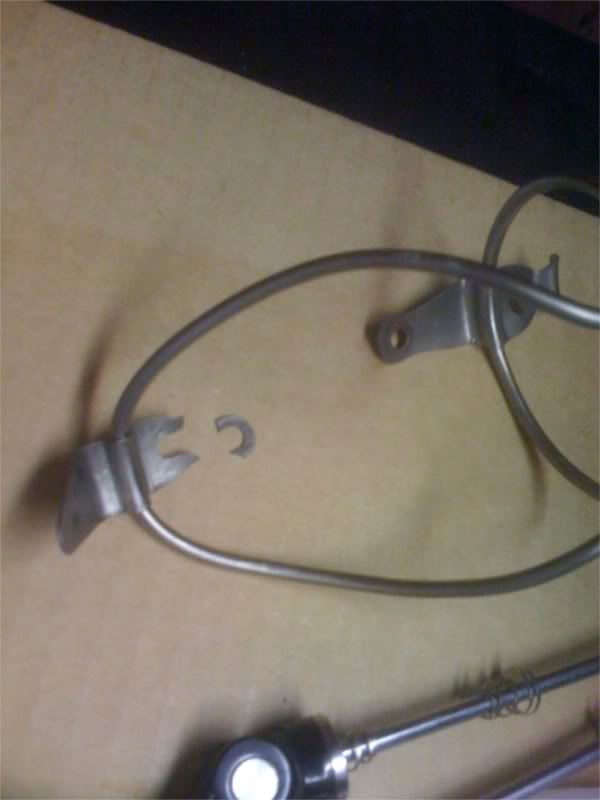

Then those mimimalistic titanium bottle cages that are made in Taiwan broke. The mounting tabs broke as the bottle cages vibrate violently as you ride the bike on dirt. I put some Tacx Taos on for the time being, and I ordered a pair of Andrews King Titanium Cages.

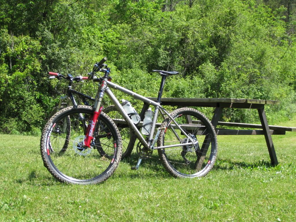

Here are some new pics of the ride:
