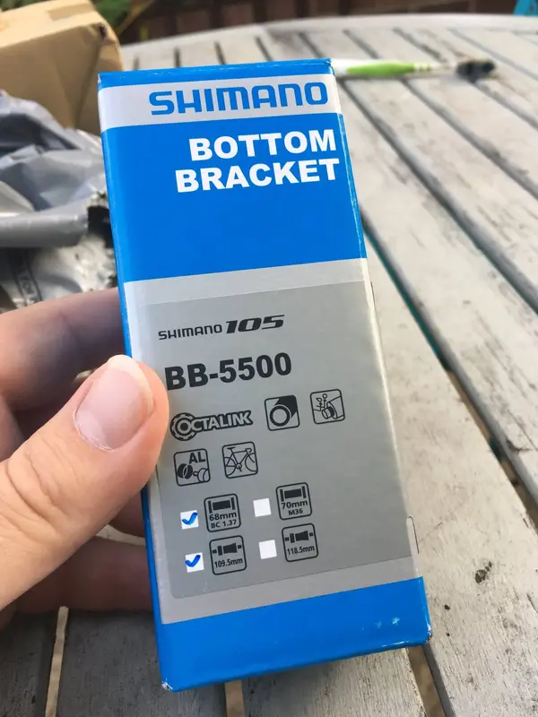

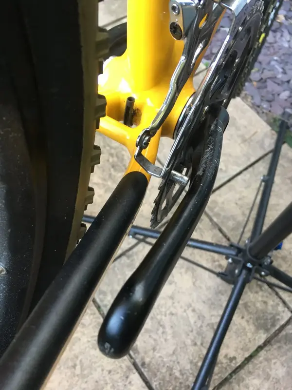

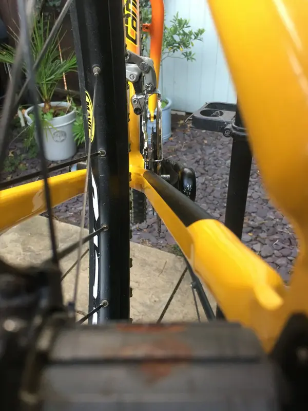

jimbog Senior Retro Guru Sep 5, 2023 #11 Just an update for anybody in the same situation. The bottom bracket I ordered is spot on for the 2000/2001 coda expert cranks. 68mm shell and 109.5 axle. Also is V1. Chainline is where it needs to be too. Thanks to @d8mok and @ishaw for the input. Attachments 59828ADC-DAC8-42AD-A02A-761437E82126.jpeg 367.7 KB · Views: 5 21081EB6-04FB-4297-AC97-5FF852F33158.jpeg 351.6 KB · Views: 4 F90732FF-FF17-41A4-B72C-92645BAAE794.jpeg 375.3 KB · Views: 4 9B18CB5F-4AA0-4C87-BFB7-BAA6DA10132C.jpeg 355.4 KB · Views: 5
