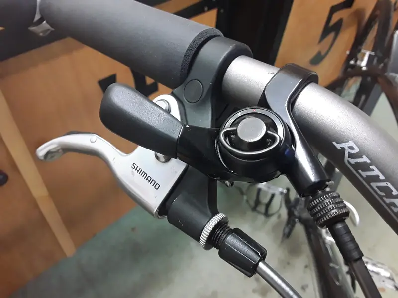

Oddly, I've just dumped that set up ( used since 2007), but only because i finally finished restoring a pair of 8 speed thumbies!
So i stripped the bike completely and gave it a long aver due overhaul!
