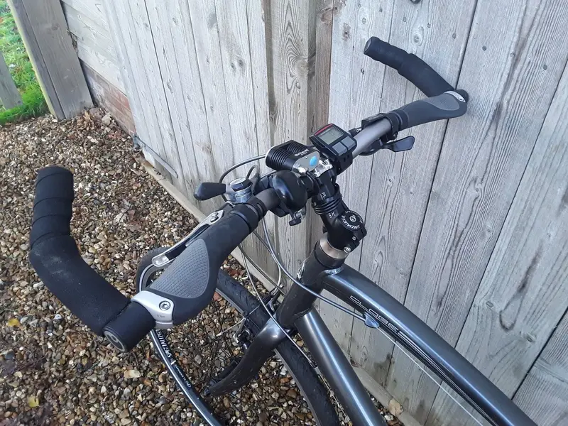

Yes...for years. I hate rapid fire front...its the lack of trim. So 8 speed rapid fire rear with thumbie front. Its not pretty, but it works a treat.
That actually looks quite good !
Would it be possible to use any friction thunbie for a front mech ?
