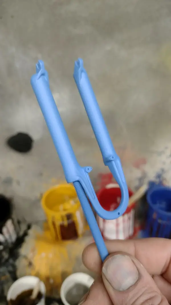

Enamel basecoat's gone on.

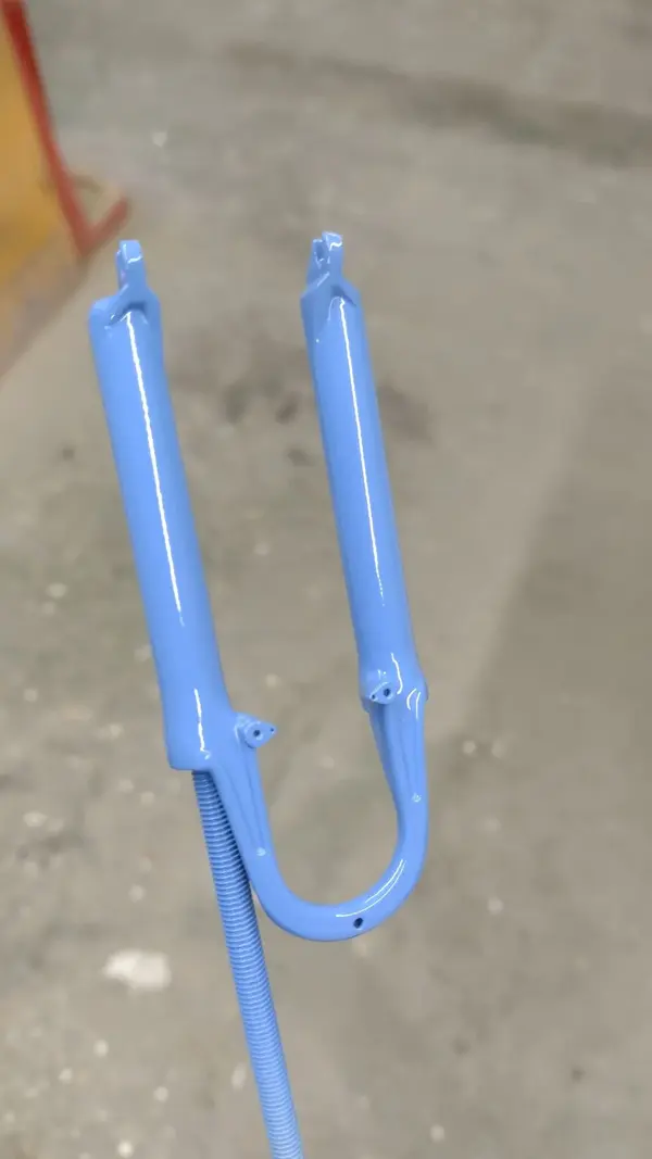

Clearcoat. This gives a nice surface for the transfers to stick to without trapping air under them.

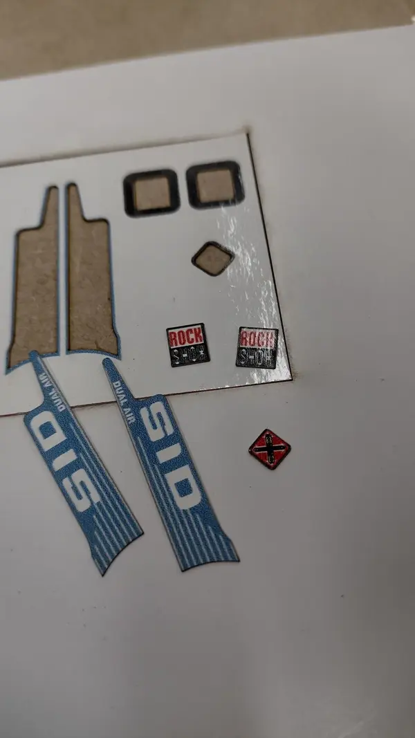

Cut them out on the laser...

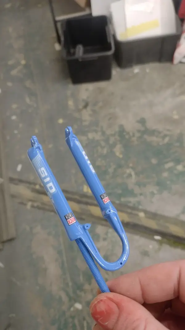

Stuck them on.
The cut edges will be touched in with a brush to get rid of the white edge of the decal once they are thoroughly dry. Then another layer of clearcoat.
I guess that's a pretty average job of applying decals...
