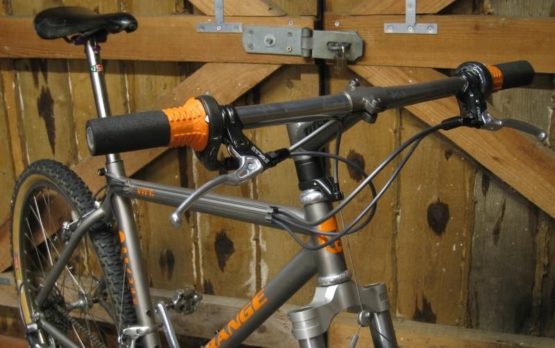

0range Vit T2 (1994) - New Pics :) - 6/2/15
Re: Re:

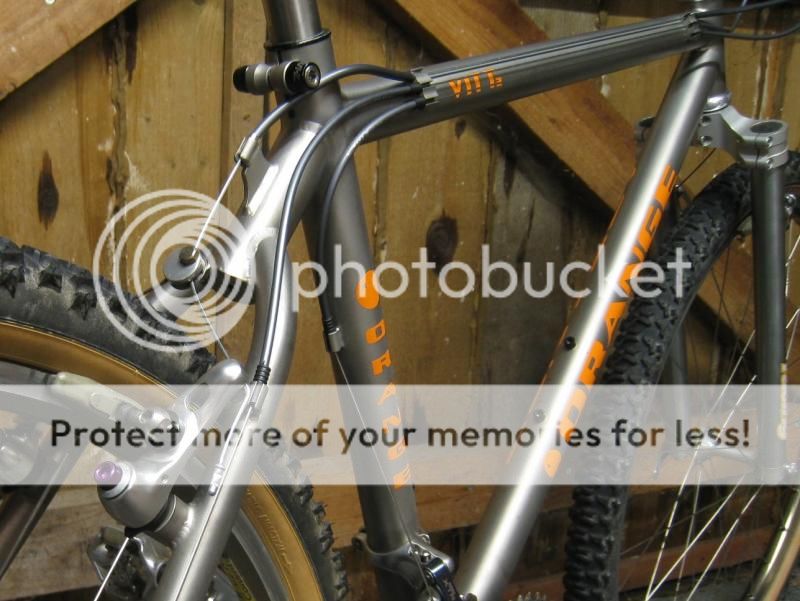

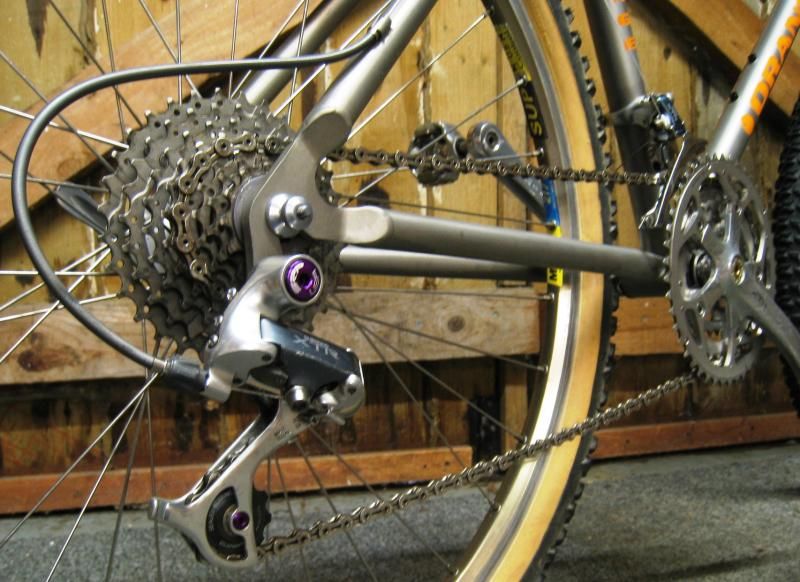

Changed the spec a bit to get the weight down!...
➡️ = Spec change ;)
Phase 2 Spec:
Frame: 1994 Orange Vitamin T2 - 1350g + brake studs (10g)
Fork: Pace RC30 (with ti steerer) - 860g
Headset: Chris King No-threadset - 80g + 10g (crown race)
Cable Hanger: Syncros Hang-doggy - 28g
Spacers: 1x5mm + 1x20mm = 17g
➡️ Top-Cap: King + alloy bolt - 8+4g
Stem: Titec Titanium (inc ti bolts) - 146g
➡️ Handlebar: DEAN Titanium - 183g + 6g (end plugs) - Now Pace RC130 - 169g
➡️ Bar Ends: Onza Titanium - 148g - removed!
➡️ Grips: ATi - 66g - Now cut down foam grips! - 19g
➡️ Brakes: XTR M900 - 156g (front) + 156g (rear) (inc. pads)- Now with ti pad holders and Kool stop pads
Cable hangers: (Shimano) - 2x13g (stradles)
➡️ Brake Pads:XTR - Now Koolstop (included)
Brake Cables: XTR outers - 45g + 22g (steel inners)
➡️ Brake Levers: XTR M900 (STi) - 390g (pair) - Now Dia-comp SS5 - 173g
➡️ Shifters:XTR M900 (STi) Now Gripshift X-Ray - 120g
➡️ Front Derailleur: XTR M900 - 122g - tuned with ti bolts - 115g
➡️ Rear Derailleur: XTR M900 - 226g - tuned with ti and alloy bolts - 201g
Derailleur Cables: XTR outers - 55g + 23g (steel inners)
➡️ Cassette: XTR M900 - 312g - Now XTR M950 - 234g
➡️ Chain: Shimano HG73 - 264g - Now KMC 9SL - 250g
Cranks: XTR M900 - 497g (L+Rt cranks arms)
Crank Bolts:Middleburn titanium - 19g
Chainrings: Shmano SG - (46/36/26) 86+49+22g
Chainring bolts:Shimano - outers (25g) inners (20g) spacers (4g)
➡️ Bottom Bracket: Shimano (xtr) UN91 - 247g - Now Action tec titanium - 136g
Pedals: Onza HO Titanium - 280g
➡️ Hub Skewers: XTR M900 - 163g - Now Zero titanium - 75g
Rims: Mavic 217
Hubs: XTR M900
Nipples: Alloy
Spokes: Wheelsmith DB Stainless - 1754g (wheelset)
➡️ Tyres: Continetal Premolar (2.125) - 638g + 612g - Now Ritchey Z-max 1.9 (WCS+Kevlar) - 533g + 602g
Tubes: Bontrager - 248g
Saddle: Flite Titanium - 219g
Seatpost: USE titanium - 189g
Seatpost Binder: X-Lite titanium - 11g
Weight: Approx 9797g / 21.6lb - Weight now approx 8983g / 19.76lb
Cheers :)
