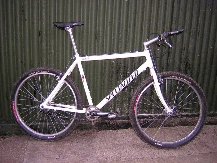

Thought I was seeing double. That looks very similar to my old S-Works M2 :shock:
Wait until you get it to plan your build, obviously need to see what needs doing first.
But, a cheap way of building a smart bike is a quick respray (powdercoats are about £30), fresh decals (from member gil_m on here) and then go singlespeed 8)
Here is my old M2 to give you an idea of the ss setup you could do >

I was planning on going SS anyway so how do i go about it ???

No real science in it.
Normal chainset will do, just need the middle ring. Get a chain tensioner (try on here or chainreactioncycles.com). Single sprocket on the back, you'll need a kit for this, again try here or CRC).
Job done :wink:
