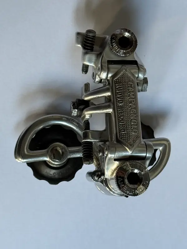

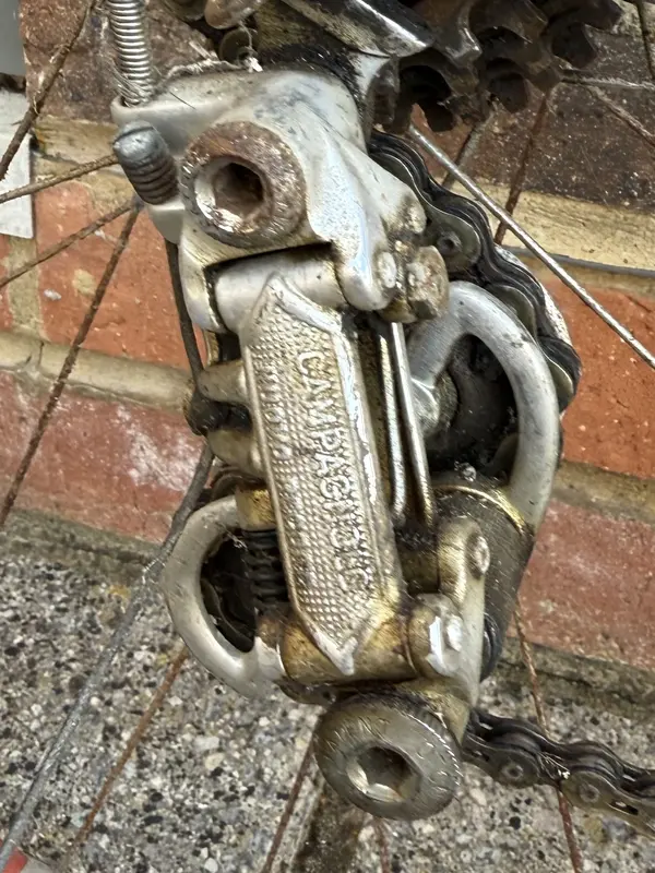

Here are some before and after photos of the cleaned components. I don’t like the “over polished” look so won’t be putting anything on the polishing wheel for now.
Rear derailleur
