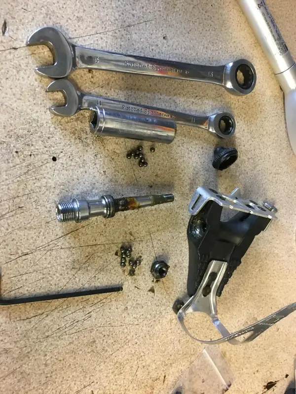

Here are some pics of my newly purchased Ofmega Sintesi pedals.
I checked Velobase to check when these were made and if they where re buildable.
They were made mid eighties onwards so period for my Road Ace 12.

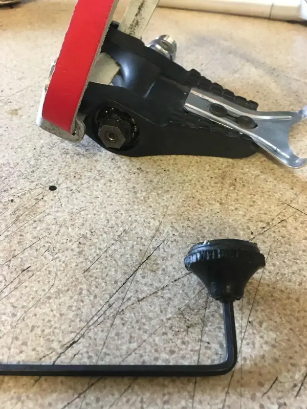

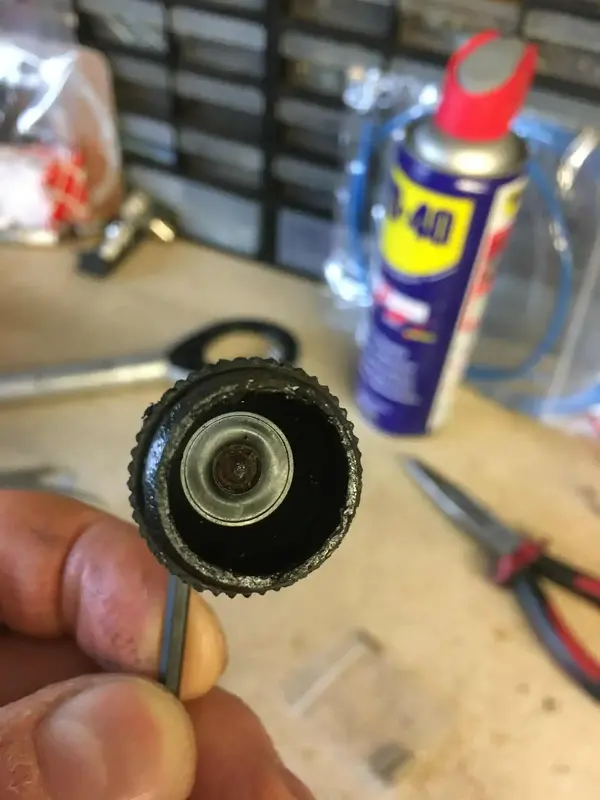

There is an Allen key grub screwed into the end cap, screw this in and the cap pops off

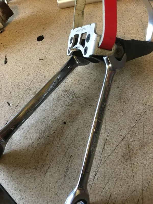

15mm and 11mm spanner to undo the axle lock nut
Axle out and all dismantled, clean up time! I used a deep socket to remove the bearing cone, I removed the leather strap to keep it clean.
Axle and cone cleaned and will go again.

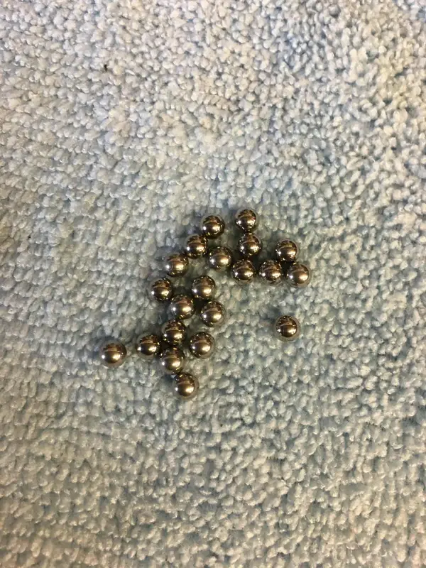

Loose ball bearings are all fine too
I will add a few more pics reassembling.

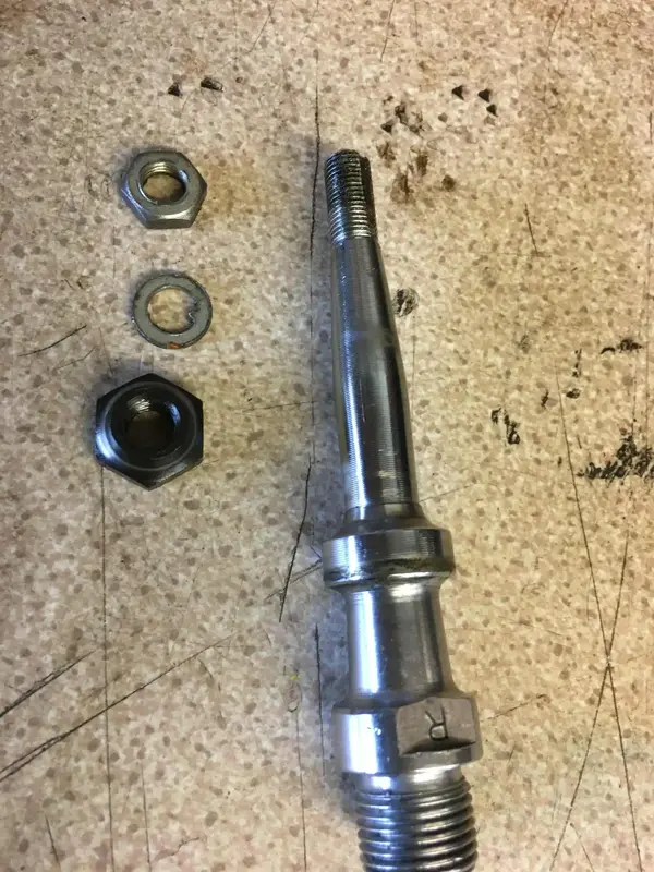

Cone, pegged washer and locknut ready to go back on.
using a deep socket to seat the cone.
Pegged washer next.
Locknut in place with 11mm spanner, take care tightening you may need to back off the cone.

dust cap note -
this cap employed also on OFMEGA pedal model CX
