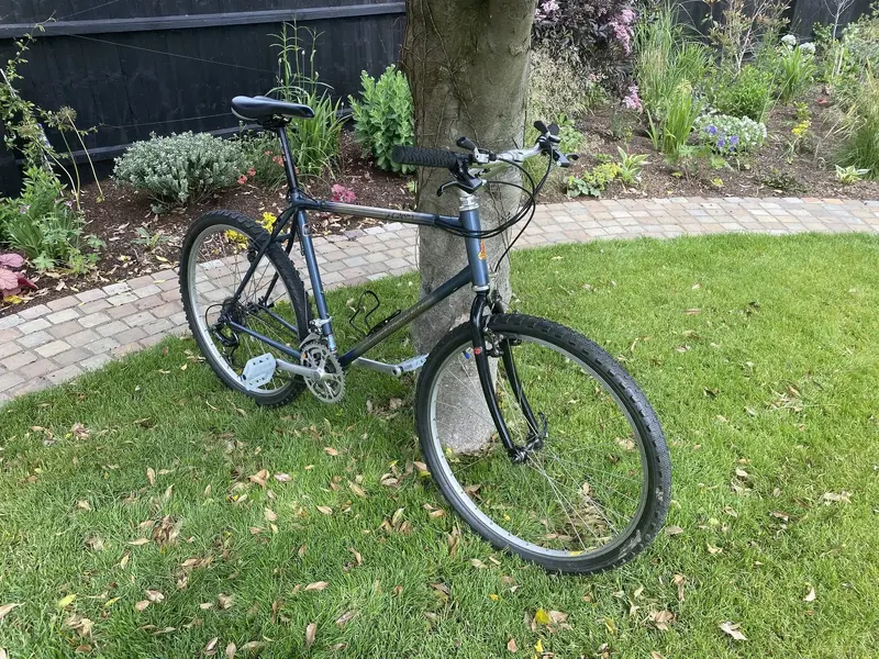

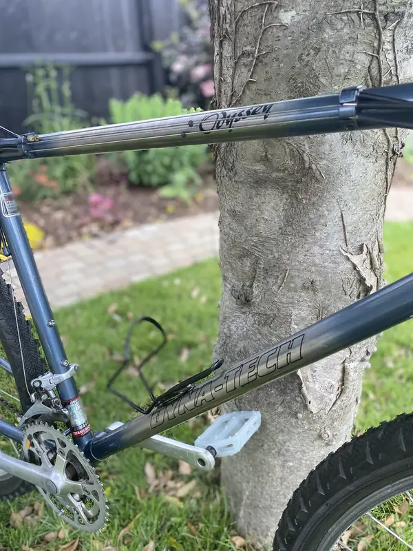

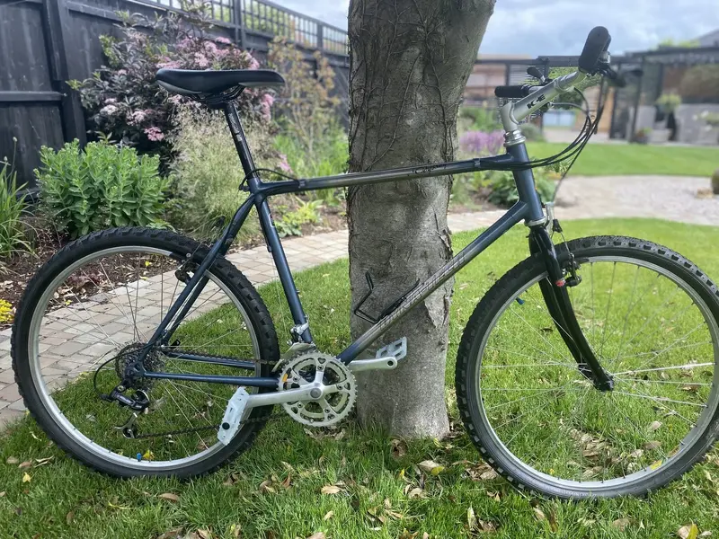

I was asked by a friend of a friend recently to source a couple of decent “old mountain bikes” for him. Mission accomplished reasonably quickly with an M-Trax already in the cave and a Bear Valley from eBay. An unfortunate side effect was reawakening some of my old eBay searches with the result being the garage (supposed to be emptying) now has a couple of extra residents. The first was a MF Courier - I’m embarrassed to post here as I’ve mullered it removing a seat post. The second is this Dynatech Odyssey, one of my all time favourites - yes Endeavour is in my searches but have never seen one of those outside of the two on this forum! Photos are as it arrived and will probably stay like for a while until I get through some other stuff - a bits and pieces build, rides really well straight out of the box and a credit to the previous owner.
I’m hoping to be educated - I’ve been trying to find this in a catalogue and can only find the version with painted tubes, this appears to be part polished/part painted main tubes with decals over which look really smart. It doesn’t have the gussets on the lugs like others I have seen - does this point to a later model?
Stem - while it’s nice should it have the painted type stem I see on most other Dynatech and does anyone have one?
I’m leaning towards a Suntour build just because I like it and I’ve got enough amassed to do so. This will be functional not perfect!

Looking at the lugs I see it's no dynatech, possibly an mtrax painted up as a later warranty replacement by Raleigh..... other than that it looks tidy but the brake levers are v brake so won't work efficiently with cantilevers and the fork is deffo replacement...original woulda been a straight blade fork.

Oh! Makes it super rare then lol! Should have gone to Specsavers etc, got excited and carried away as it was cheap! Don’t think I’ll lose any sleep and I’m sure the seller wasn’t trying to pass it off knowingly.
The finish is really good in terms of the paint/fade to polished titanium and the decals. So what model might it be in the Mtrax range? It’s a good few kg lighter than the Mtrax it replaces which I guess it would be ti main tubes vs crmo.
So the forks should they be UGLI forks?
To be fair, the paint does look really good, an mtrax woulda had either a unicrown or an u.g.l.i..... and I am happy to be proved wrong on my diagnosis tho if folk wanna pipe up.

The Odyssey was full M730/32/35 XT including seatpost. Reynolds 2070 tubes (equivalent to 653 tubing) Wishbone rear stays and straight blade Reynolds forks.
As RBG has mentioned, your Odyssey is definitely more likely to be an M trax painted up in the Odyssey colours. It's looks like it's been done to a fairly good standard, so I'd second the opinion it is a warranty replacement for a broken Odyssey.

Thanks for the replies guys!
I think RBG’s suggestion it is a warranty replacement makes the most sense. I don’t think we’re talking Harry Butler/Magnum Bogus Hetchins type shenanigans here!
While it’s possible someone could reproduce some of the decals, it does have the holographic Dynatech tube decal with serial number on the seat tube which I guess would be a little harder to come by or reproduce unless direct from Raleigh. Frame number begins with E which from the little information I can find about RSP numbering conventions would indicate it’s probably a 1994 frame. Main tubes are non magnetic pretty sure they are titanium, head lug is also non magnetic. The other lugs are magnetic as is the rear triangle.
So someone had a bust Odyssey and Raleigh built/painted the nearest they could to a new one? Could you imagine a manufacturer doing that now and trying to emulate a previous model rather than just refund or sending a newer model. That’s pretty good service.
Still really pleased with it and will press on with a build at some point once it gets to the front of the queue.
Think I’ve pinned down what was the likely base for this “warranty replacement”. The elusive 1994 catalogue would help.
The 1994 Dynatech Diablo frame looks identical to me down to the cable stop integrated on the seat post clamping area and the fade paint (albeit in a different colour) on the main tubes.

Had some time to spend updating/improving my “Odyssey”. Didn’t really know which way to go with it as I didn’t like the forks, stem and bars. Given it’s heritage as a likely warrant replacement using a later frame there were/still are a few options. The frame I think that has been used would have had U.G.L.I forks and an aheadstem. I managed to get the right stem but wrong colour, the forks don’t appear often and are probably going to cost more than the bike if they do come up! So I thought again - I like the combination of the colour coded spinner type forks and Flexstem on Mahoney1978’s Sentinel and the Flexstem was used in the range on the Endeavour. So…..a quick look at the paint code used on boy”O”boy’s Odyssey build and I was able to get the forks that came on the bike painted (greenhouse spray booth) my first attempt so not great but not bad either. The paint looks ok match wise, it’s not the exact colour on mine but hard to tell from even a couple of paces away. Added a Flexstem, changed the saddle to another Turbo I acquired and restored and it looks loads better. I think tan walls would set it off and I’ve got loads in the garage I could use but this ones for riding so el cheapos for now. Pedals need changing but will leave for now 4F0F7374-5F67-4E67-942C-84D0D4DCF245.webp FD49CB1B-61CA-4760-B9C1-0245257639D2.webp
