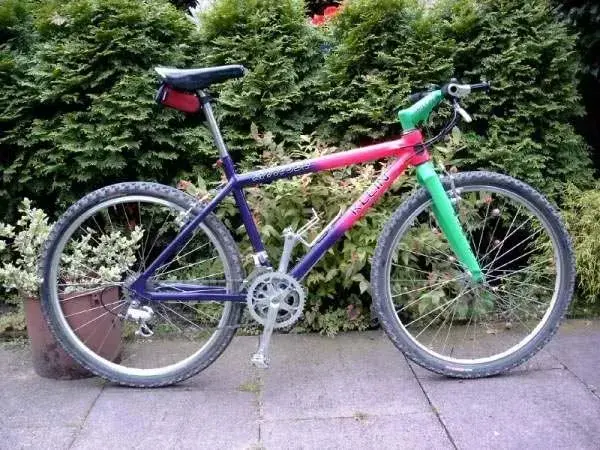

Attitude is ALMOST a Storck...
But not quite...
Similar though...
Cheers,
BB.
