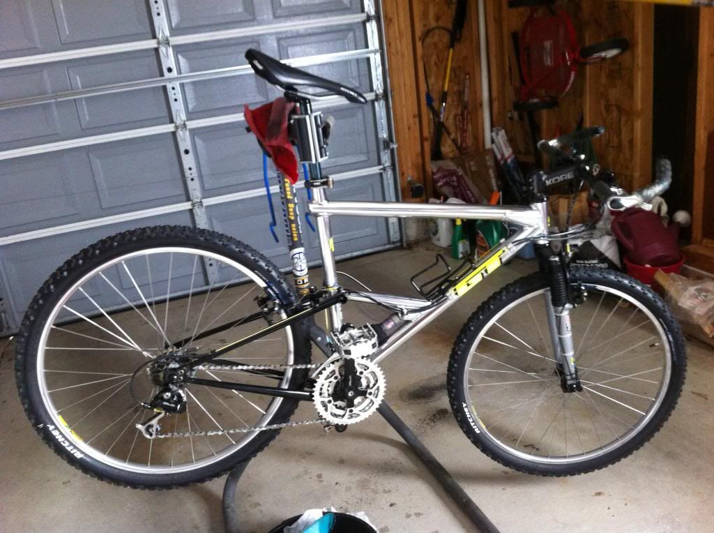

Here is it last year being prepped for a nice easy XC trail ride = 40 miles.
Love the full suspension as it keeps the rider very comfortable.

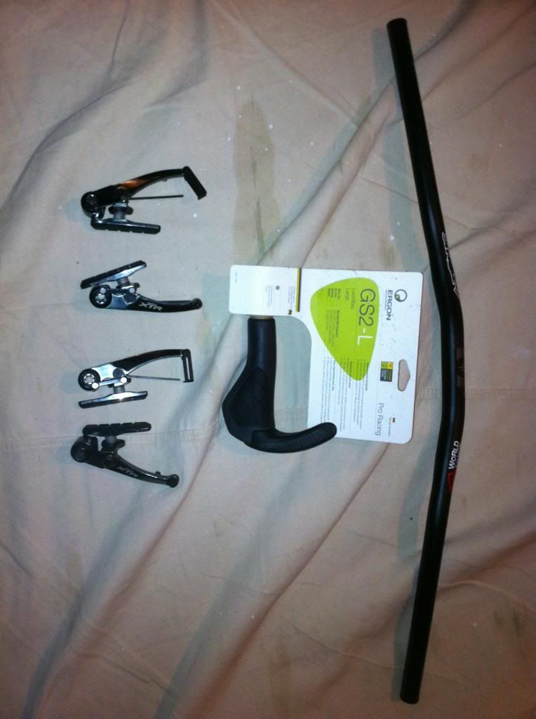

I decided to upgrade! handlebar to have a 2" rise, update the grips and replace the cantlevers to shimano XTR V brakes .

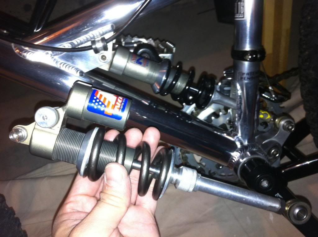

Decided to check ebay and saw a great deal on the frame with a in great shape adjustable Noleen shock!

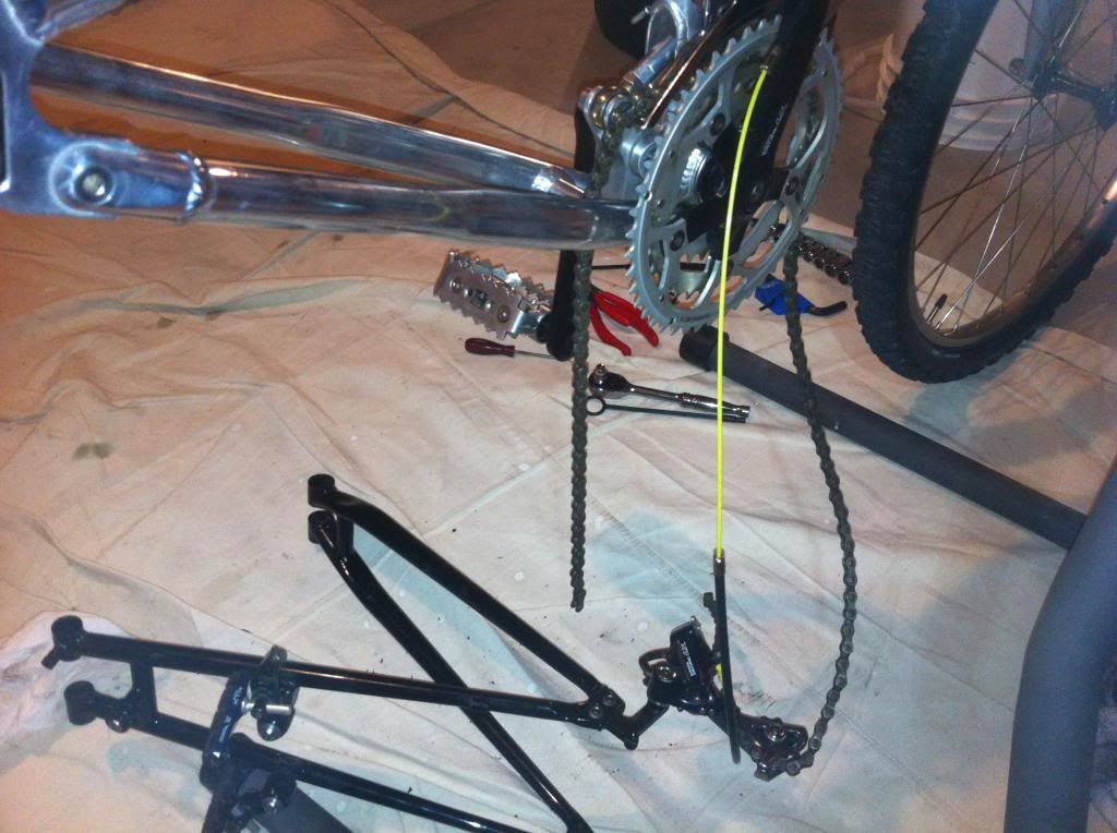

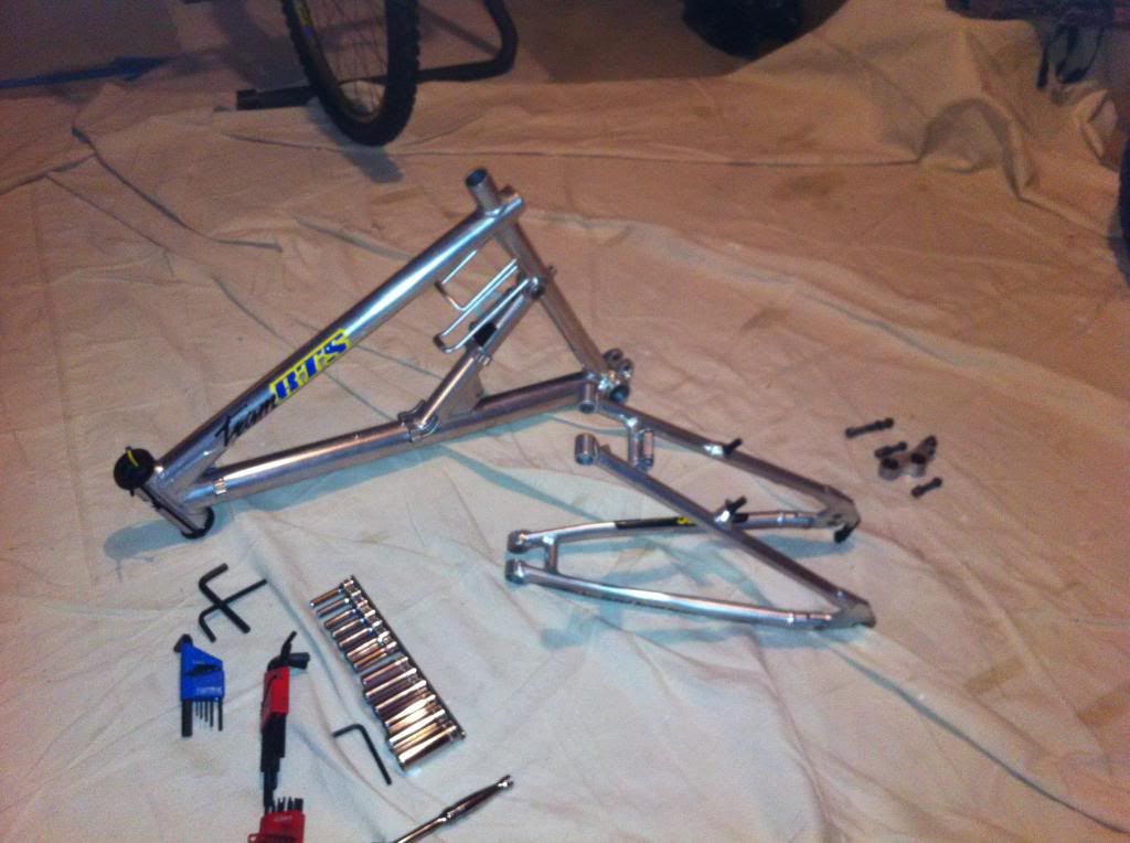

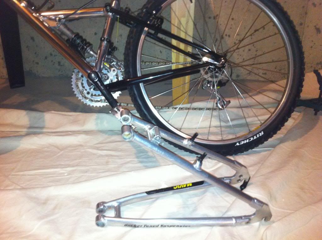

Objective one - swap the rear aluminum to replace the cromoly rear then add v brakes:

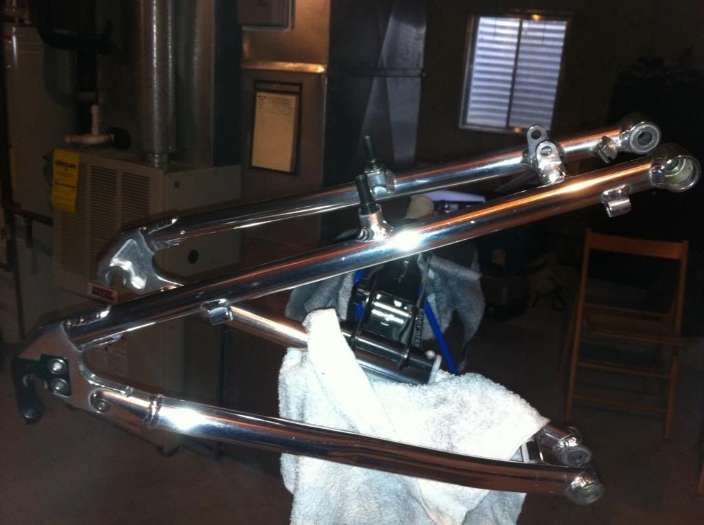

A little TLC on the rear aluminum arm makes it look brand new:

nice! be sure to keep the cro-mo rear end. imho they are cooler than the alloy, just more historic, even though they lack the pivots. hard to find to it would seem.
great to see your bike still going strong, thats quite imprssive

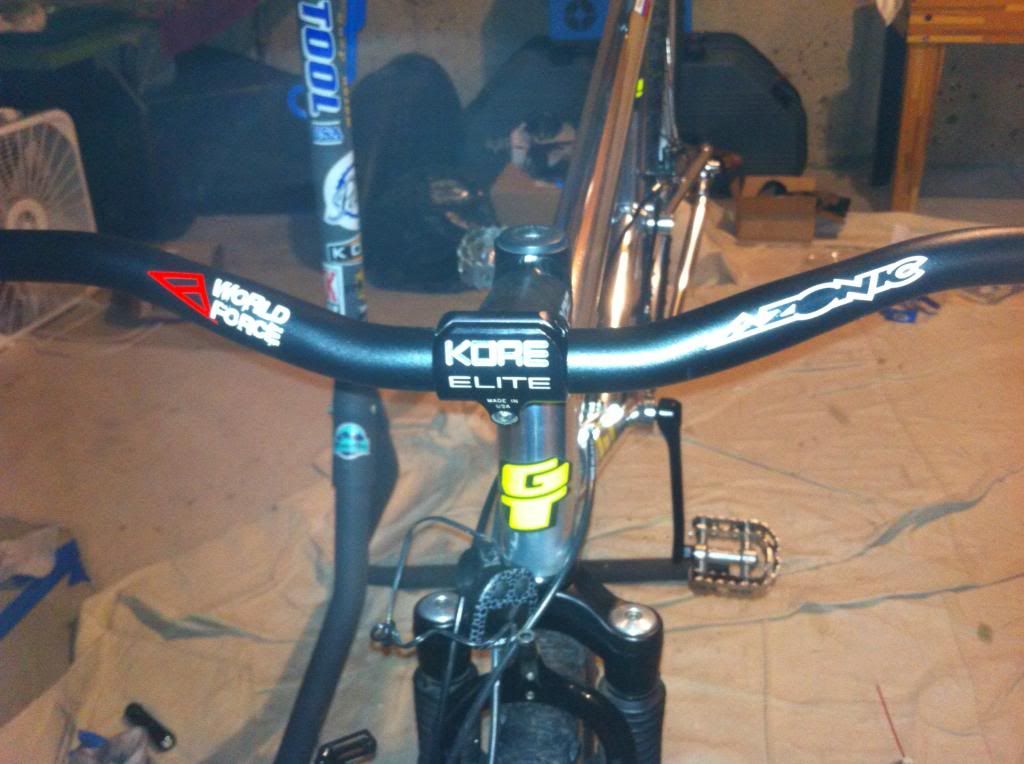

now for the handlebar - its 25 inch compared to 23 inch of the original bar:
just have to add the new grips:

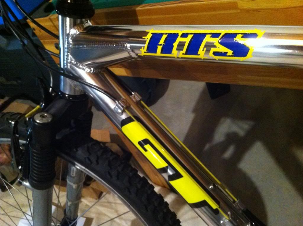

decided to add new RTS badges:
came out great:
First test ride this year:
Snapped a few quick pics outside:
Success! first ride - shifts perfect, brakes way better and bike feels lighter. I like the new Noleen shock d titanium rear spring vs. non adjustable steel spring.

Thank you sir, will do! I'll definitely keep the cromo rear end around for sure!

Those brake levers are not meant for use with v brakes, braking performance will feel very strange. Mushy, and then very sudden full power.
That is why I took it out for a test ride and it felt just fine! So not sure but it felt great to me maybe I'm used to cantilevers?
Its got a nice progressive feel to it then full power.
