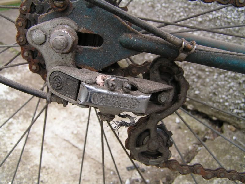

Blimey it takes a bit of ingenuity to make a track bike geared :)

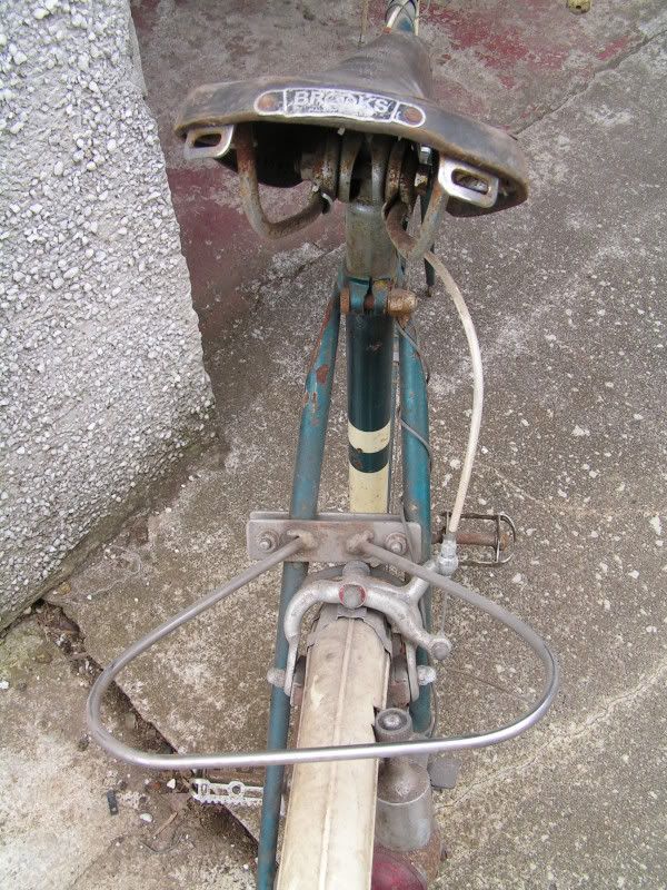

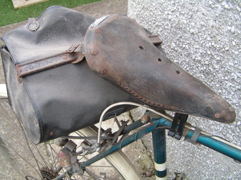

That is absolutely stunning! Get stuck in with the dubbin and that Brooks should come up like new. Mine was in similar condition when I got it.
I can't help with the exact dating, but the combination of the parts and the paint scheme make me think it's a 60's bike. I think the Huret derailleur is later, maybe late 70's.

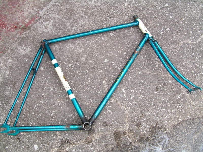

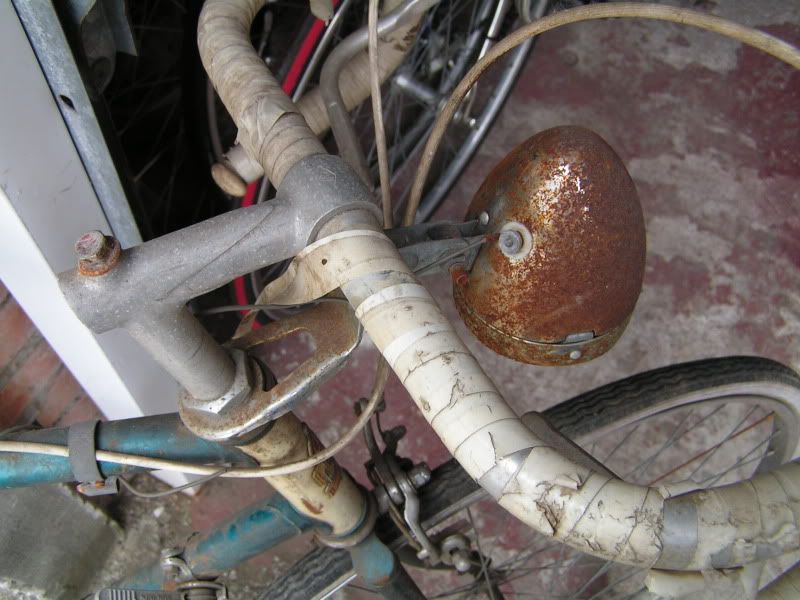

Looking at the seat tube, which has similar paint style to me '63 cordon bleu, i would say '63-'68.......though the suicide levers might date it later, or be an add on!
Good work. I'm with Piperdave, the plain Prugnat headtube lugs make it post 1963. CB seem to have painted them any colour you wanted, so it might be difficult to pin it down more closely. The lugs seem to have gone frilly for the 1967 model year again. OF course, it's a road / path frame so equally at home on the banking or with guards and saddle bag on the road...

Stripped down to a frame and a small pile of usable bits. Does anybody know the purpose of the oil soaked roll of thick cardboard which was inside the bb shell. I'm assuming it was to stop it rusting from the inside.
There is a grease nipple on the bb shell. The paper keeps the grease in, and prevents it going along the frame tubes.
