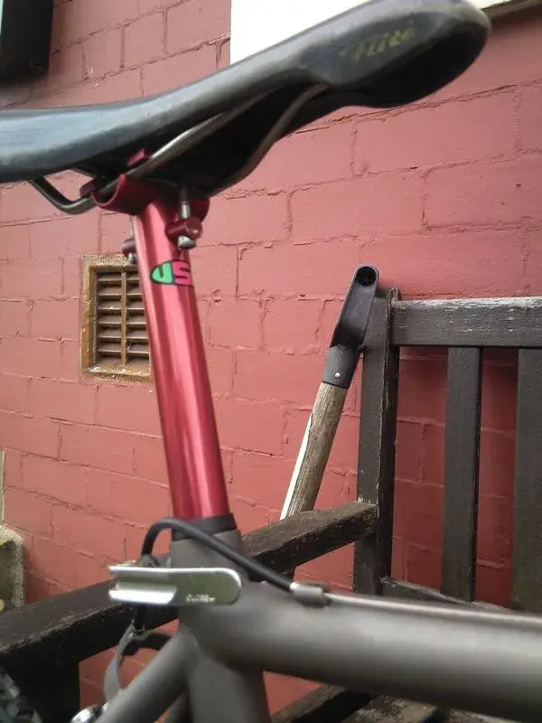

Having said that, the bike already came with a few ano red bits that I quite liked so kept the theme in mind when procuring new parts for it like the seat post and inner chainring. Speaking of the seatpost, the frame turned out to be just as the '94 MBUK mag said by way of the seat tube being slightly too big for the 27.2mm post. I got it wrong a few times but in the end a 25-27.4mm USE shim sufficed.

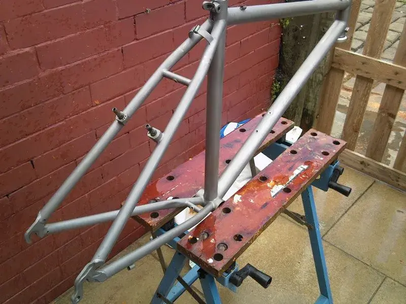

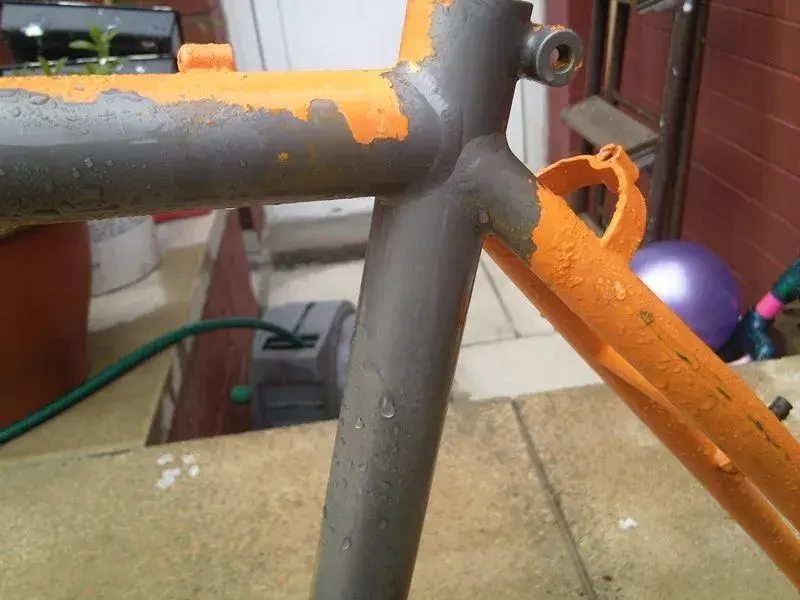

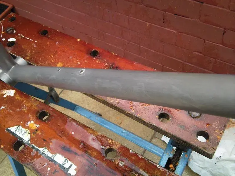

Anyway, Nitromorse. Hurts like f*@k when you get it square in the eyeball but pretty good at shifting Halfords spray paint when used correctly. Basically follow the instructions on the tin to the letter, plenty of cold water and a stiff old toothbrush will do the trick - I'd say 8hrs straight to do a medium sized frame although I spread that out over a couple of weeks, culminating in a last ditch attempt to complete the job at midnight over a few cans (and the rest) of Bud. Hmmm, midnight drunken nitromorsing...interesting. But when morning came the end result was good enough for me and even revealed the imprints of where the original Marin decals had been, the outline of which could be seen to read "team titanium" on the Top Tube, putting to bed any last remaining doubts that this was indeed genuine.

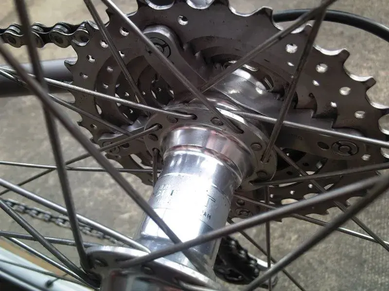

Original spec is currently as follows;
Frame 17.5" (with Gil Decals)
Maintou EFC (optional when new)

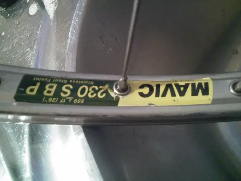

Mavic 230 rims on White Industries front and XT rear hubs
White Industries cranks
Marin Lite Stem (n.o.s)
Marin Lite Handlebar (n.o.s)
Marin USA needle Headset
Marin Lite Front Cantis
LX bottom bracket
XT shifters & levers
XT rear mech
XT front mech
XT pedals
Non original spec;
Marin Rockstar Sierra 2.1 tyres
USE seatpost
Flite Ti saddle
Ritchey foam grips (close match)
KMC chain
Specialities/Middleburn rings
XT rear cantis
XTR cassette
Weighing in at 25.25lbs (3.6lbs frame).

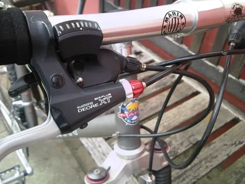

Some more pics...

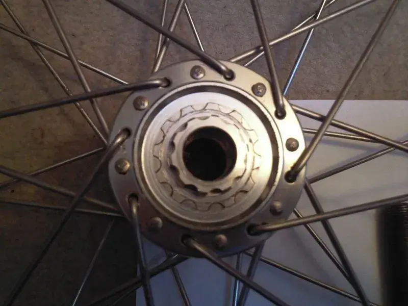

more...

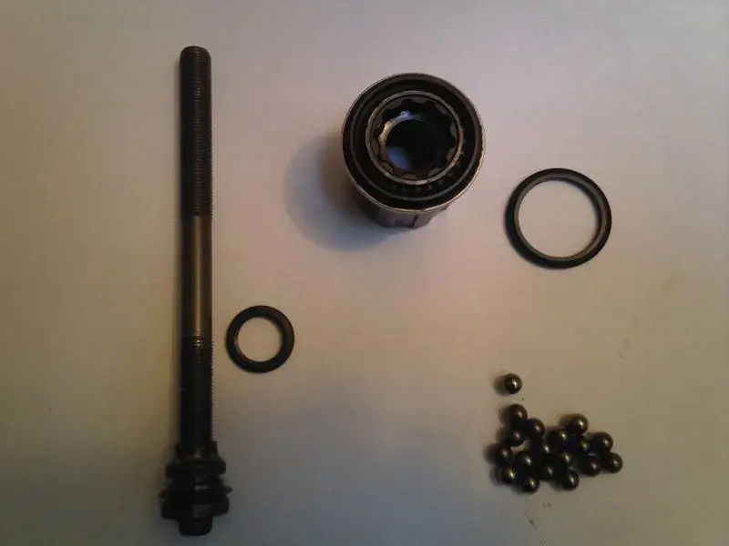

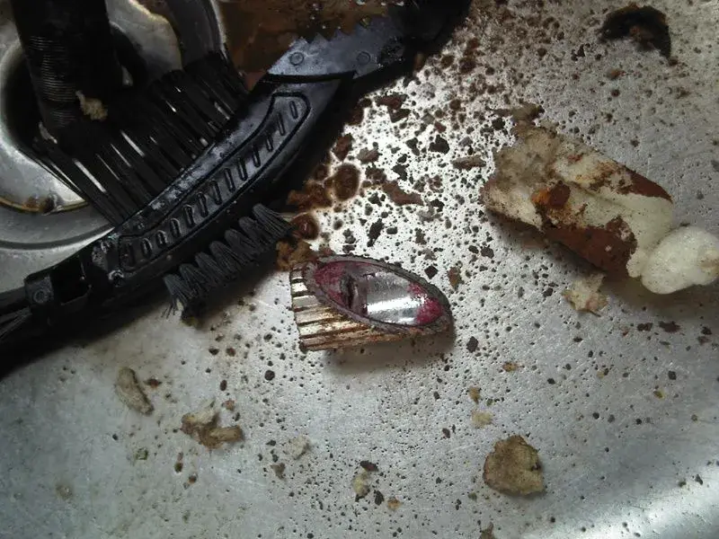

more

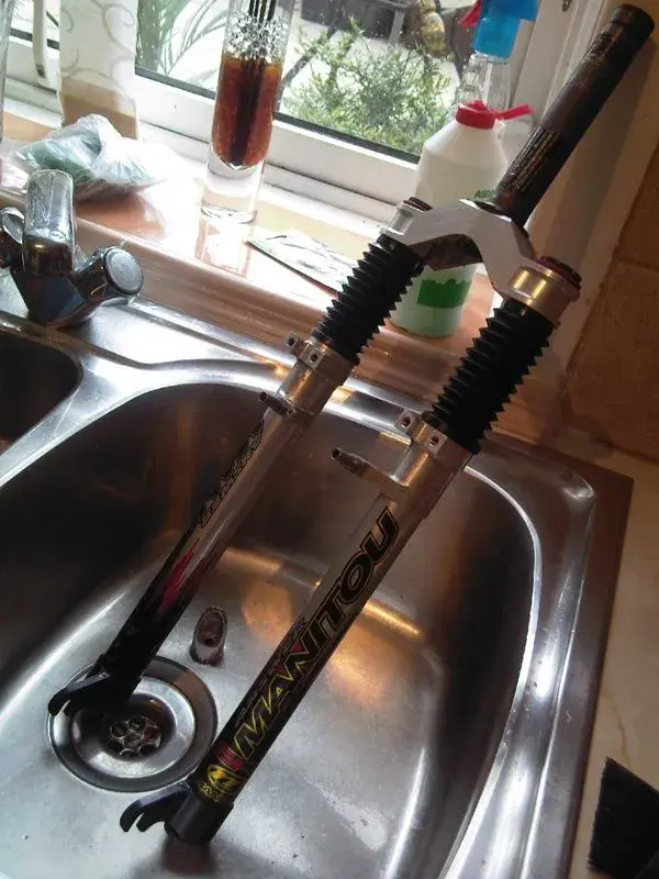

More!
