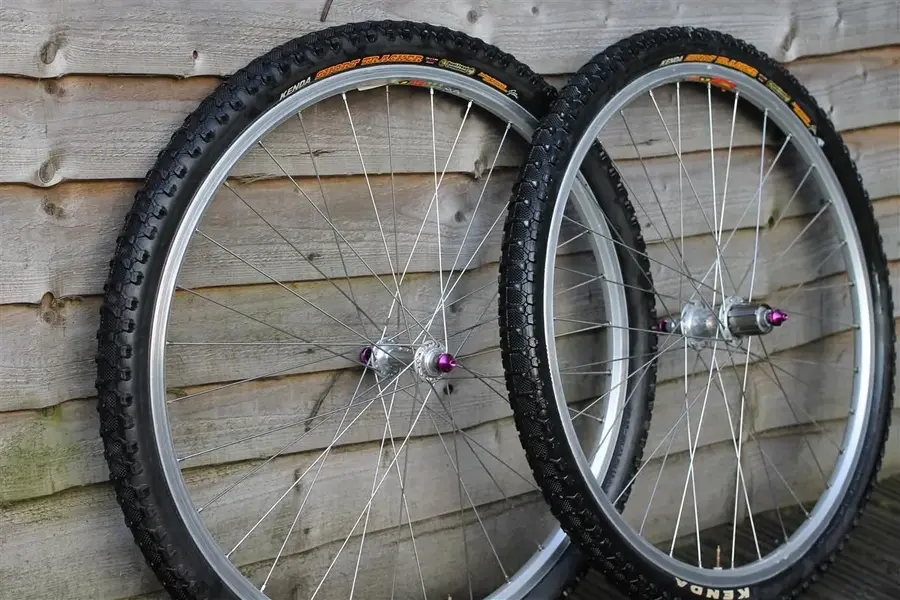

Had the chance to sort out the wheels this evening, looking nice. Mavic X517s with Hope hubs (Lightweight front, XC rear). Kenda Short Tracker Folding 1.95" tyres. Pretty lightweight combination, too - wheels 740g/960g, tyres 405g each, tubes 130g each, skewers 30g each.

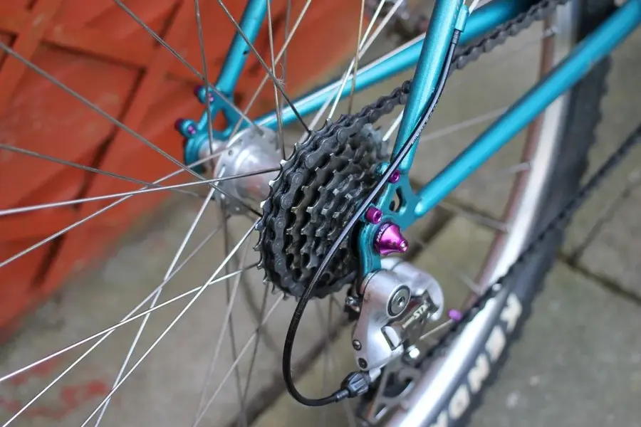

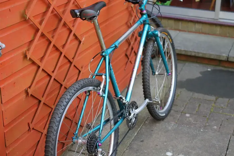

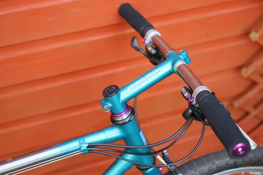

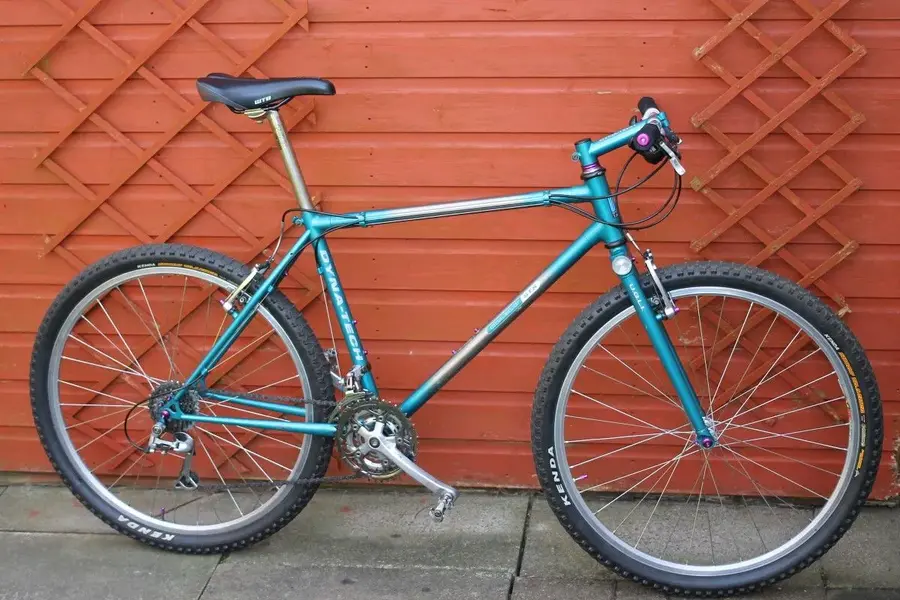

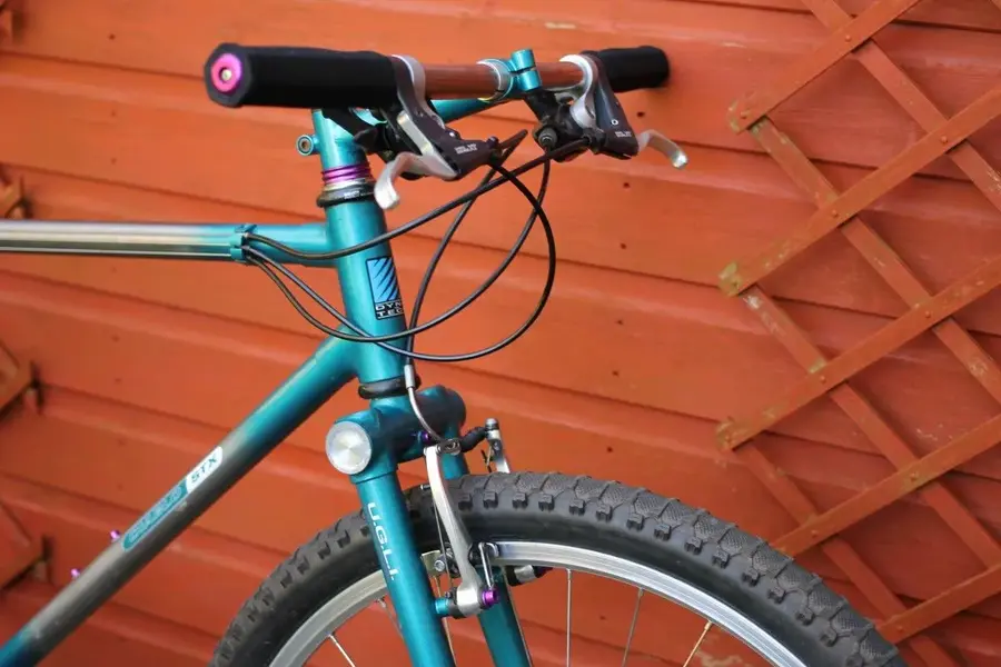

The Easter weekend gave me the chance to finish off this little project. Here are the new photos. I weighed it and it comes out around 24 1/4 lbs in the current setup.
I even got a nice ride in on the same day (on the Lanchester Valley Way and Waskerley Way). It rides just great and not having had a retro ride for a little it brought back a few memories: i) how much fun rigid is, ii) how straightforward 7-speed drivetrains are even compared to 9-speed.
