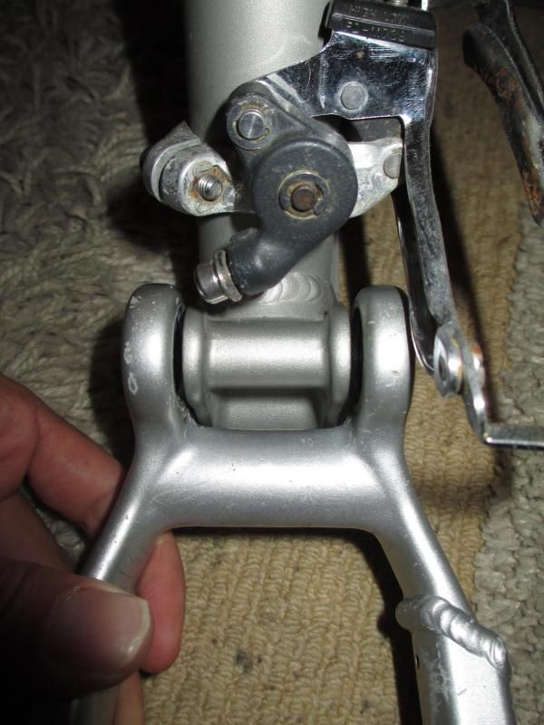

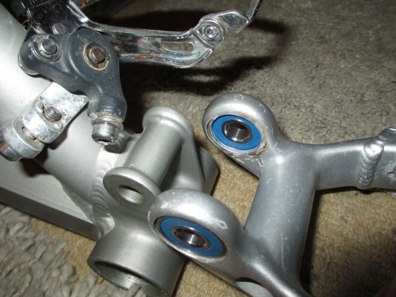

Pics of my current-incomplete- setup:
with the bolt:

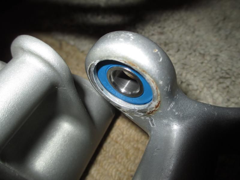

there is about a 1mm gap eitherside between the bearing housing and the frame:
and about a 2mm gap between the bearing face and the bearing housing:
my initial thoughts are to find 2 sets of washers measuring:
M10 x 22mm OD x 2mm depth
M10 x 24mm OD x 1mm depth
but if anyone else has a better idea.....i'm all ears...
