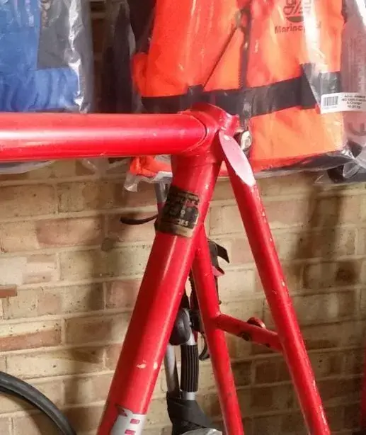

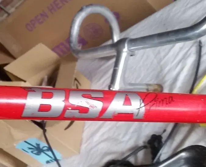

This just landed in the coop.
It comes with no-name (Raleigh?)bars/Cinelli stem, Shimano bottom bracket and no-name (Raleigh?) headset. And the usual Weinmann brakes and levers. As well as forks...

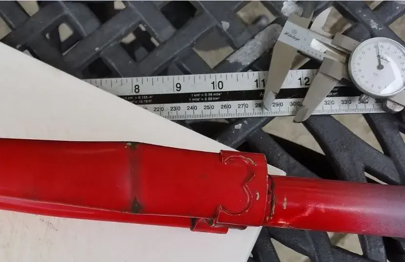

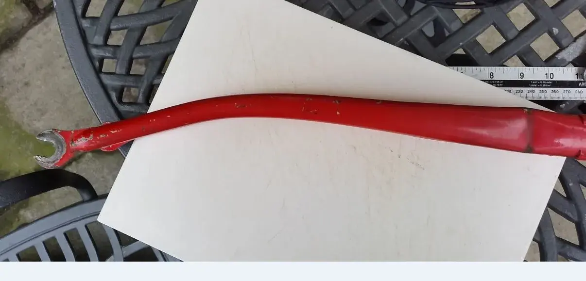

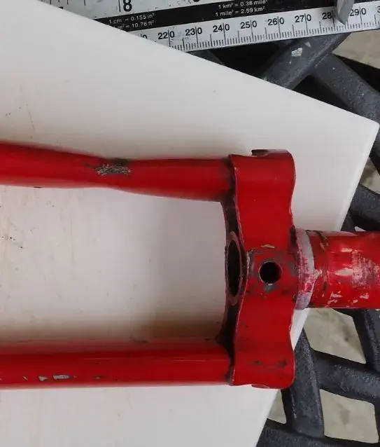

Ah yes, the forks! Nowhere in the ad was there a good picture of the forks, nor anything in the description, that prepared me for this when I went to collect:
Having driven the best part of 100 miles I wasn't best pleased as you'll imagine. But the frame is sound, and is 531 "tre tubi" so having negotiated a substantial discount on the asking, I brought it away.
So anybody got a pair of Raleigh forks they can spare? Frame is 22.5", steerer tube 187mm by 1" diameter, threaded 26tpi and a rake of 2". Length from top of crown to tip of dropout 380mm and with forged no-name dropouts with no mudguard eyes. Obviously I'll put a wanted ad on here too.
Frame number is WS0 000246. Which makes it a Worksop build from December 1980.
