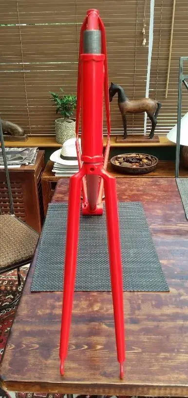

And actually the forks turned out to be 1" steerer, and very nice too. From a Dynatech and thought to be 531 too, which is a bonus. Many thanks to forum member Goldie for supplying them at a more than fair price as well.

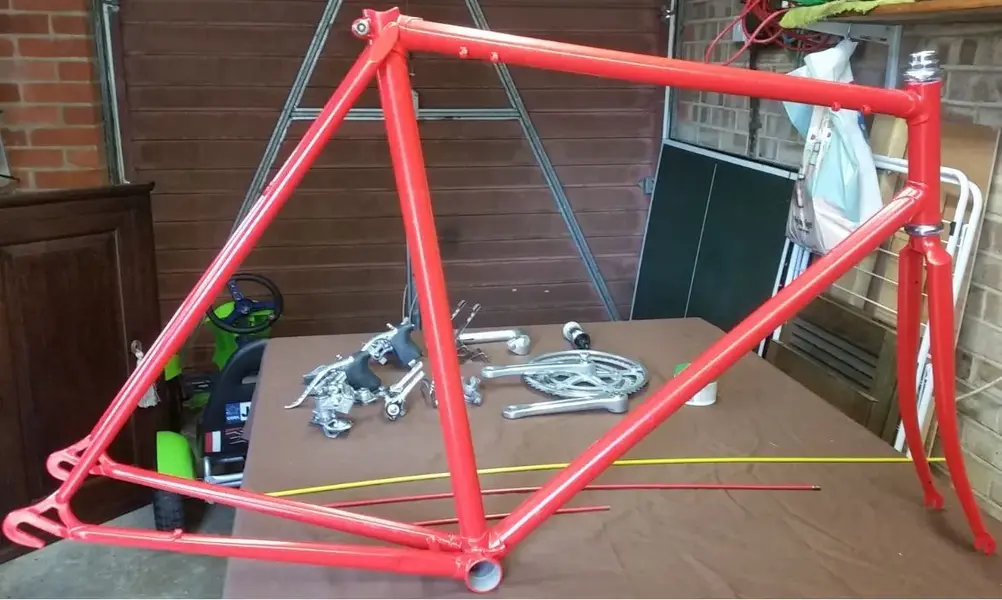

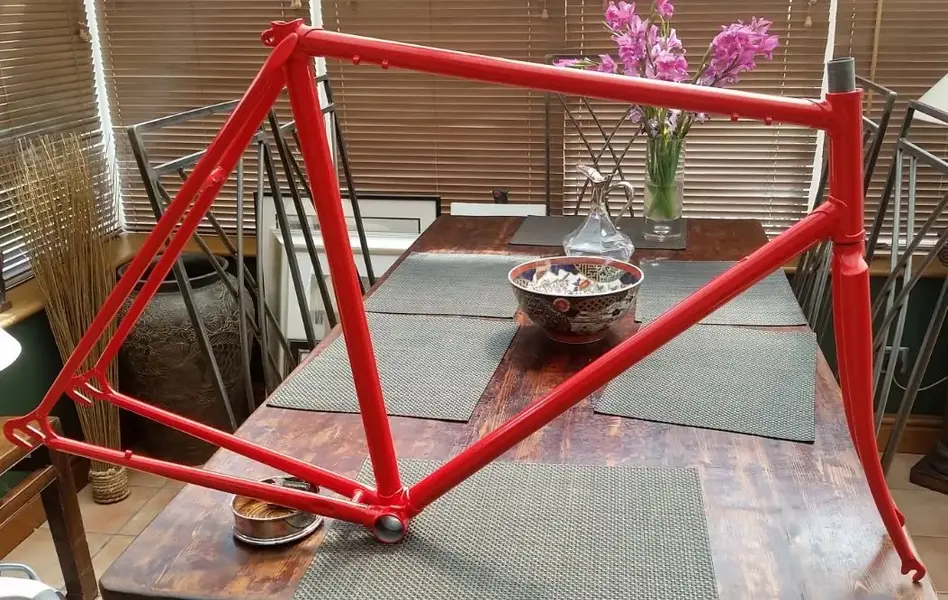

The frame is back from the powder coaters. They have managed to match the original colour just about exactly. The usual very high quality work from them as you'll see in the pics.

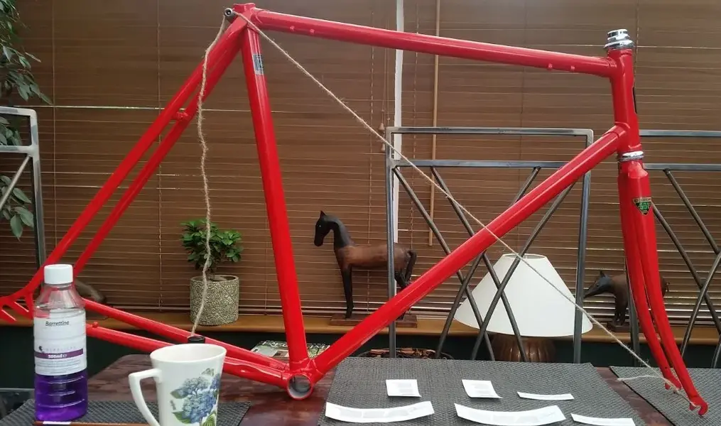

And Steve at hlloydcycles has, of course, performed his magic to duplicate the original "Prima" decals. They are not avalable anywhere "off the shelf". They're in the post.

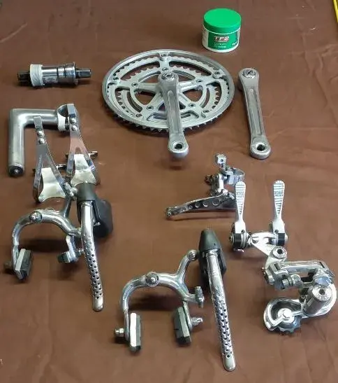

Sure did Chris. A nice pair of (Edit) Weinmann 36h alloy clinchers laced with db spokes to Normandy sf qr Luxe Competition red label hubs with freewheel threading. The rims are Belgian made. Not as soft as chocolate I hope...
Also an SR 27.2 fluted seat post, some SR Road Champion bars, a pair of SR sf11 platform pedals and a nice close ratio (14-20) Sachs 7 speed freewheel.
Not too sure about the pedals - were they mtb types?(Edit) No, according to Velobase they are touring pedals. What sets them apart from others I'm sure I don't know. They have polished up very nicely I must say.* And, weirdly, the nice engraving on the bars is underneath! New one on me!
Edit. Oh! And a lovely old B17 Champion Standard in excellent order. All of the above courtesy reynoldsfan on the forum.

Oh yes! That looks awesome! The forks look right at home. Really looking forward to seeing this come together.
Thanks Luke - yes it's coming on: decals (mostly "specials" which I have thanks to Steve at hlloydcycles) and probably lug lining next. Aside from tyres and tubes I have all I need to finish off.
And those forks! I think they look completely at home on the frame - despite the steerer being about 3mm shorter than the original. A rummage in the spares box discovered a suitable thinner spacer and hey presto! they're brilliant.
Re: BSA Prima project - decalling
Careful prep for the downtube positioning
