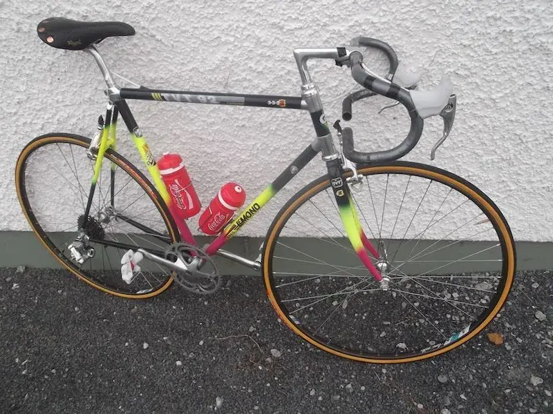

Hi,
I am trying to set up the brake levers and delta brakes on this bike, I am currently building.
These brake levers have me stumped along with the delta brakes.
When placing the inner brake cable in the barrel like part that holds the cable end, which way should the slot in the barrel be - should the slot in the barrel be facing towards the seatpost or the other way.
I read that these are "powergrade levers whereas the leverage can be adjusted by turning a 1 mm cap screw" The barrel that holds the cable end can be adjusted up and down.
There is also quick release on the lever and + and - etched onto the front of the lever.
I presume the quick release bolt should be set as per the 1st generation ergolevers.
I have already tried cabling the rear delta brake up. All I have achieved to date is 4 frayed cables. The end of the brake cable in the lever body has popped out the couple of times I have tried to get it set. I didn't realise the whole delta brake could move up and down on its mount :facepalm: .
Any advice regarding setting them up would be great.

if you look at the part that holds the cable it has a counter sink for the brake cable nipple to slot into.
They are a bit of a bugger to set up I always do it without the wheel in the frame with the cable adjuster set to give the maximum amount of cable adjustment. Put the wheel back in & adjust the inner cable to the correct length before cutting it.
Hope thats of some help? but I always struggle with them so Just take your time.
