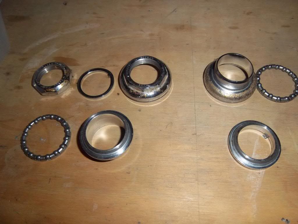

I have had a trawl around looking at prices etc. It looks like the Tange Levin headset I removed from the Gazelle had a stack height of around 33mm. The cheaper Tange Passage has a stack height of 30.1mm. What are my options?
I would like to check the stack height on the headset i removed - what exactly should i be measuring?

The headset is not in the frame - this is it at the moment -
Do i measure all the bits and subtract the sections that sit in the stem?
Richard

Re: Headset Stack Height
Just as midlife says , simples . Then just use a spacer anyway as Matthew 71 says . Buy it , fit it , and see how many spacers you need , as it's easier than cutting the steerer down :wink:
Put the whole headset together, correctly. As it would be in the bike.
Measure the total height.
Subtract the length of the two stubs that are inserted into the headtube (the bit on the frame) then subtract the thickness of the lip on the lock nut.
It's all in the park tools website.
