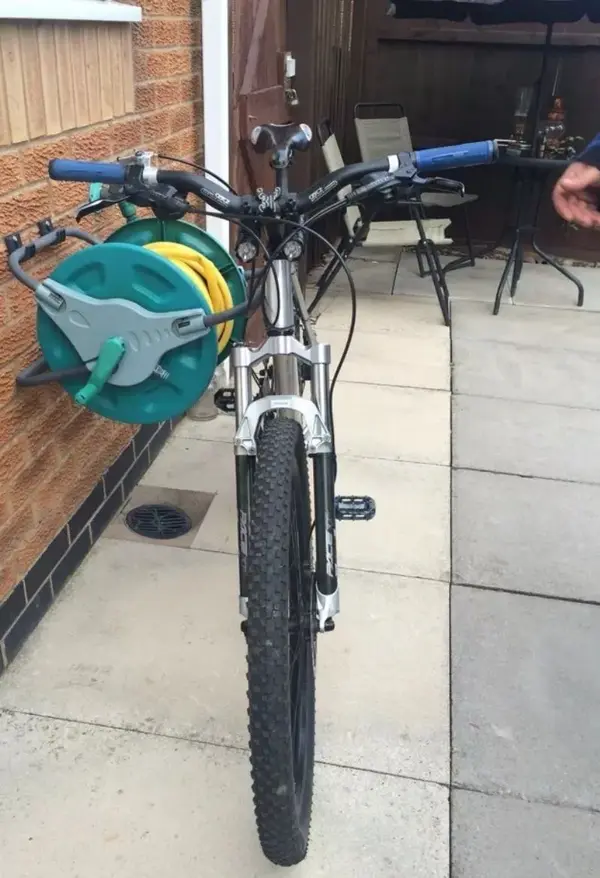

I have just picked up a GT Zaskar with Pace RC 36 Forks.
The forks have a remote lockout but I cannot for the life of me work out how to replace the cable - the outer is knackered.
Anyone know how?
I have looked on the Pace website but am still none the wiser.
Thanks
