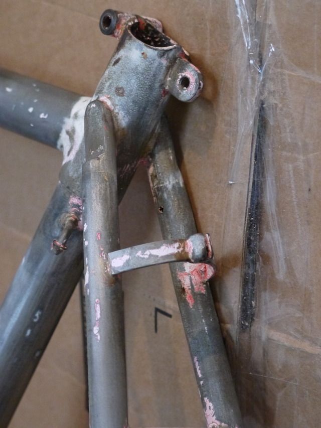

This frame was outed in the ebay section, and I was pretty sure it was a 1985 Jamis Dakar.
I've been after one of these for a long time, so did a deal to get it across from the US.
Further investigations have led me to the conclusion that it's not :(

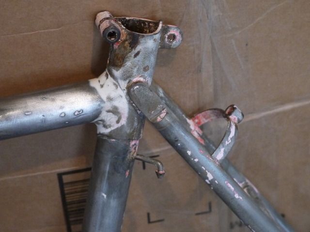

And some pics of the frame...
I'm going to take it to be bead blasted this week, to get the last of the paint/primer off.

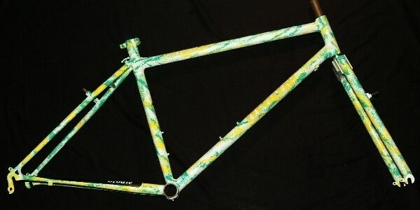

As far as I know it isn't a Jamis as they TIG'ed everything then used filler to look like fillet.

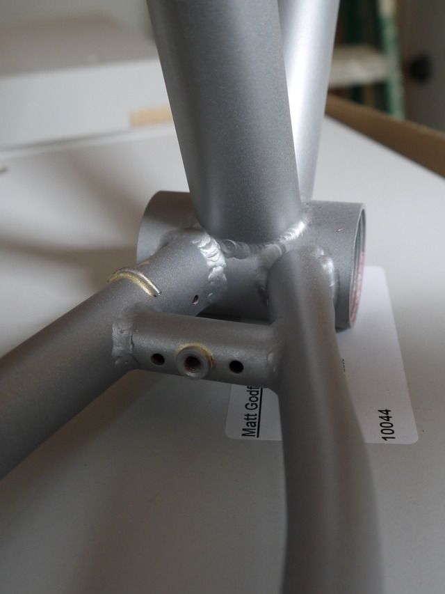

The seat tube definitely ovals where it meets the bottom bracket, very much like my later 1993 Dakar.
The early Dakars were properly fillet brazed. It was the lower models (Dakota etc) that had the faux fillets.
I've not seen a Breezer with a forward facing seat clamp, or pump mount/hite-rite tab, but I've been wrong more than once already :lol:

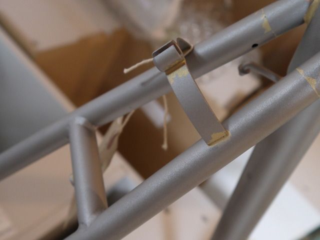

I've seen similar tops on the seat stays to that before - can't remember where :?

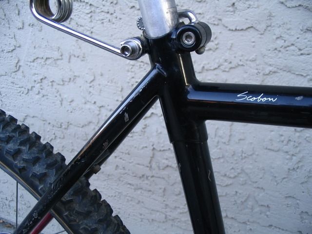

My Brodie Romax has those (fender mounts) on the seat stays (I ordered it that way bitd), and it has the front/back hite-rite and seat-post clamp arrangement like that as well.

LGF has pointed out (on the ebay thread) that there is an early Muddy Fox that shares the flattened seat stays, so maybe this is what you're thinking of?

I found this image, which shows the forward clamp, Hite-Rite tap and also looks to show an oval seat tube?
I've not seen a Brodie with a pump mount though?

The top of the seatstays and brake bridge, are very reminiscent of a late 89 early 90s Yates, or similar from TWG, even with the pump peg and hite rite tab.using
concept tange.
never seen a frame number stamp there though.

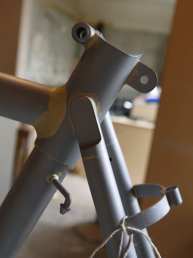

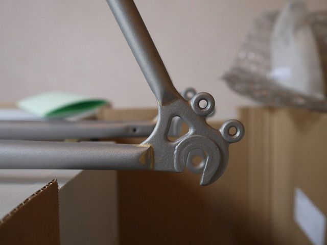

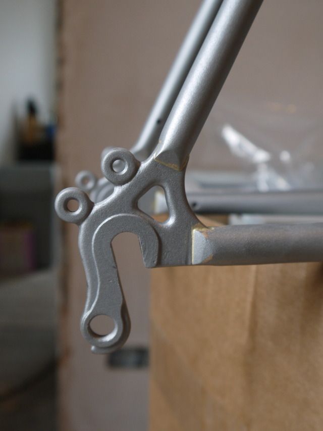

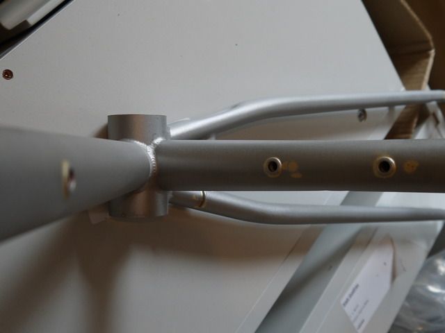

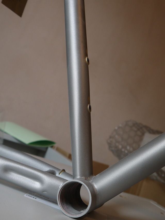

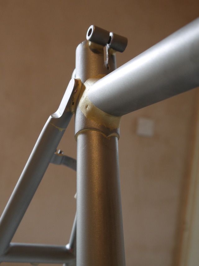

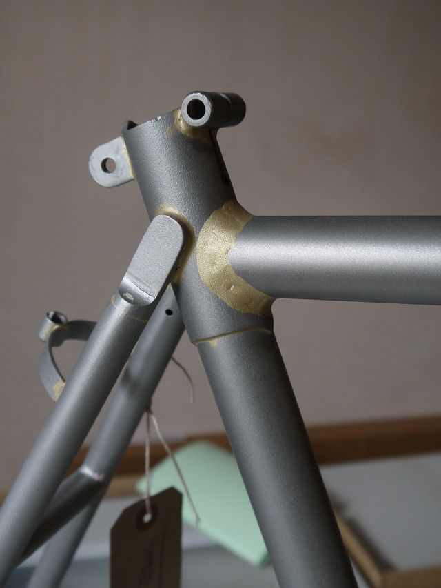

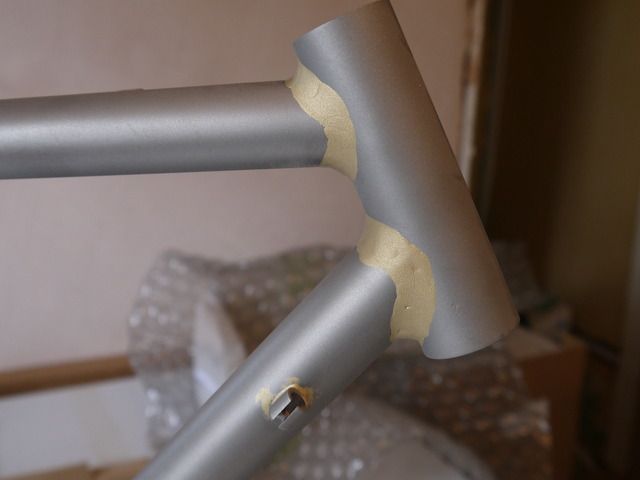

Just collected the frame from the blasters.

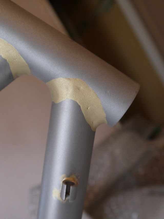

With the remnants of the paint/filler gone it's easier to see a things.

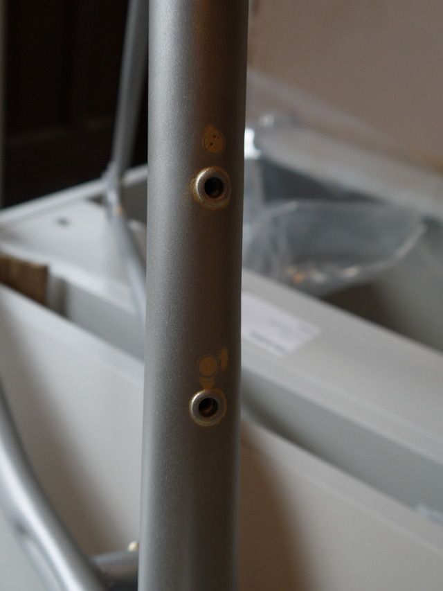

The frame construction is a mix of TIG and fillet brazing. The fillets look to have been roughly finished and then filled to smooth them out.
Loads more pics, in the hope it helps someone id this!
