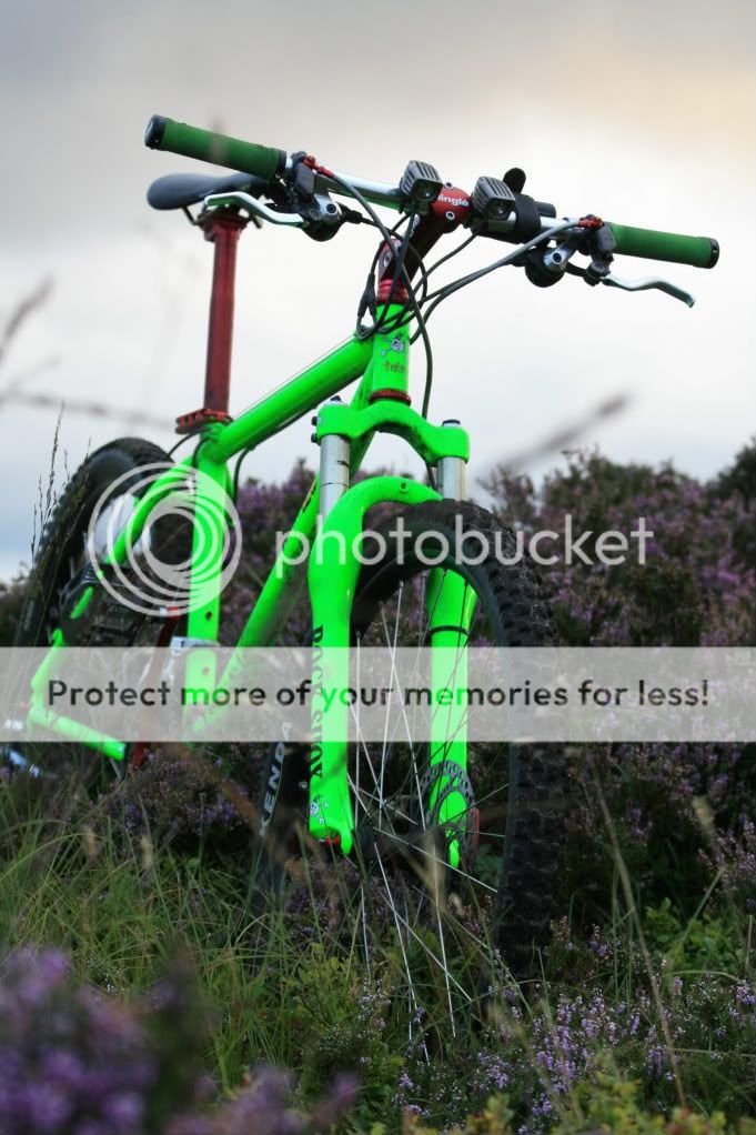

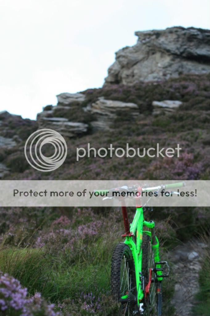

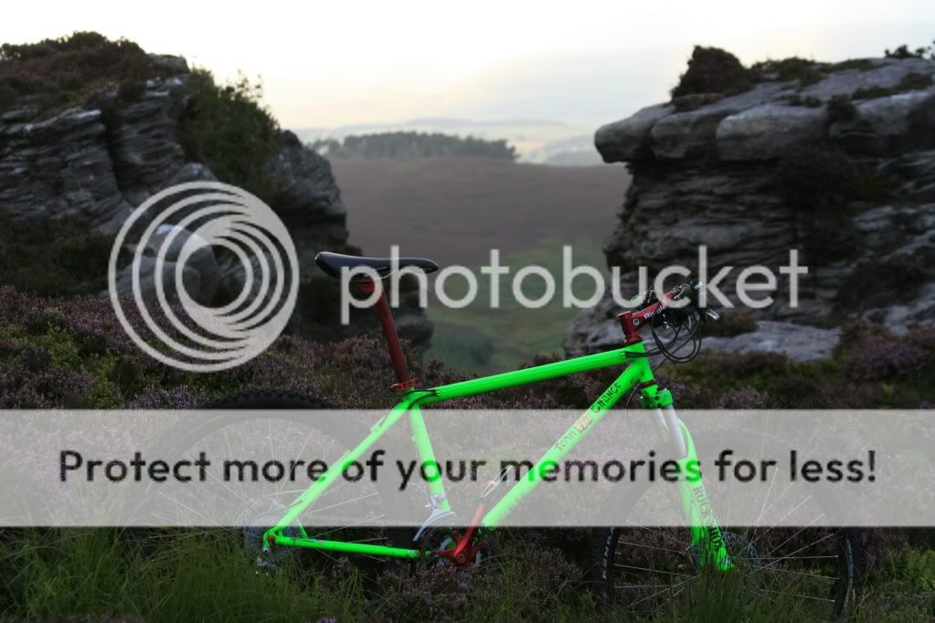

Until I find time to do the changes though I'm going to continue using it at every opportunity. Heres a few pics from last weeks nightride.
Good lord Si, they are some pretty serious changes! :shock: Sure it'll turn out well though. Guess it'll need a re-spray. You sticking with the same colour?
Contrasting fork colour? Tough choice though to find something that goes with the extreme green.
Dr S":cp4j69ss said:
I will be painting the fork to match the frame matey.
Excellent.
Much as I think I should dislike everything about that bike in terms of the fluoro paint and the green/red contrast I can't help but love the look of it.
One of the best looking bikes on here. And fantastic quality finish to everything on it.
