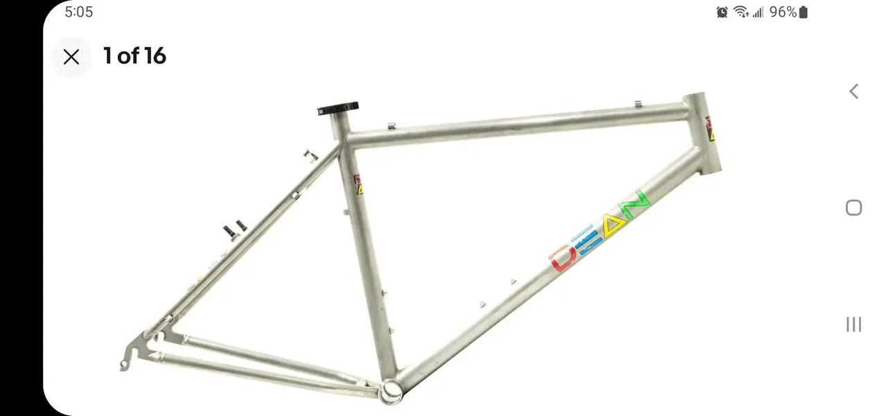

Looks quite similar to the older 1993 ish dean cable lay out. Bullet stays but older pre colonel cable layout rather than the side saddle top tube routing. It desperately needs a shorter stem and regular seat post. Not a fan of the suspension post. Rear hub has some play, I'll have to remember to hide all the tools and bits I'll need to work on it next time I'm down. Screenshot_20240224-170548_eBay.jpg
