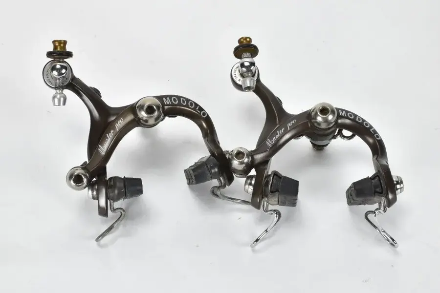

For brakes of the day Modolo Prof with the sintered blocks gave the best stopping power some modern blocks & cables with the older calipers give better results than the original kit

I just built my brakes out of the bits that remained reliable/viable from two or three sets. One of my Modolos broke a spring. The thread on both pivot bolts disintegrated. One of my Shimano 600 stirrups developed a hairline crack at the brake block slot. So now I'm using Modolo stirrup arms on Shimano bolts and springs, with generic blocks. Campag levers with Modolo 919 anatomic hoods. I should've got two or three pairs of those hoods instead of one back in 2000 or whenever it was. I actually prefer the shape of the Modolo lever blade- flattened out near the tip- over the Campagnolo, but I don't have the Modolo levers any more. In every other dimensional particular I'd say the Modolo levers at/near the top of the range are faithful Campag copies, and equal quality. Mavic are rebadged Modolo. The Modolo sintered blocks are reputed to wear out rims pretty fast.
I had some modolos bitd and thought the sinterized blocks were crap. They were better than rubber blocks in heavy rain, but in every other scenario the rubber ones were better.
