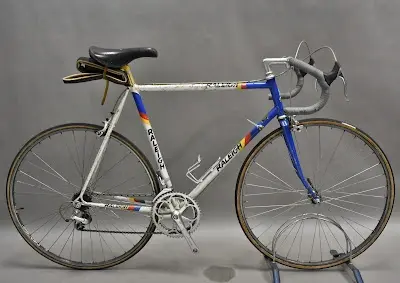

Raleigh Team Cadet/Flyer forks? Maybe not a Raleigh? Can't find any Mk7 Professional pictures. Sorry everyone i'm still very much the novice and I know Raleigh catalogues are not always 100per cent accurate.
I think its a Raleigh Panasonic Team Replica 12 well at least the frame is but not the fork? This picture comes from The Flying Wheel blog thank you. The quality of the picture is better on the blog as you can't see the head tube lug details on the one below but you can in the blog. _DSC3061 (2).jpg
I think its a Raleigh Panasonic Team Replica 12 well at least the frame is but not the fork? This picture comes from The Flying Wheel blog thank you. The quality of the picture is better on the blog as you can't see the head tube lug details on the one below but you can in the blog. View attachment 800139
The Team Replica models used the Mk7 Professional frame so not the same. Most likely the frame is a Competition, Gran Course or Road Ace with lower spec fork. The full top tube cable guides had probably rusted and been replaced and painted.
The Team Replica models used the Mk7 professional frame so not the same. Most likely the frame is a Competition, Gran Course or Road Ace with lower spec fork. Most likely the full top tube cable guides had rusted and been replaced and painted.

I once made a list of the Raleighs that used that particular frame style. With the frame in hand one might be able to identify it more precisely.
Having said that, I have one of those frames that doesn't fit any of the catalogued models ...
