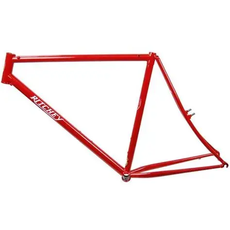

About the best AL frame I owned had a "Plexus Stay" design. Not really much to do with geometry, but still.
You see this kind of thing repeat itself in bike design over and over again through history.

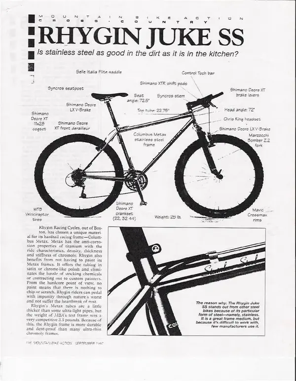

Yup. Not common. They also did some road bikes and a CX too that survived much better. No wheel flop with this one.
Steepish head-tube, slacker seat-tube, short wheel base (I don't think they even bothered with a chain-stay bridge). I reckon on the
right stretch of fast flowing narrow off-road with more modern rubber, the right rigid fork, flat bars cut to 540mm it would literally be like
sitting on a thrilling missile without a point and shoot feel to it; probably a niche between and knock the socks off any modern
29er MTB and Gravel bike.
Definitely would be interesting with hours of fun dialling it in to find that sweet spot balance of front vs. rear weight.
