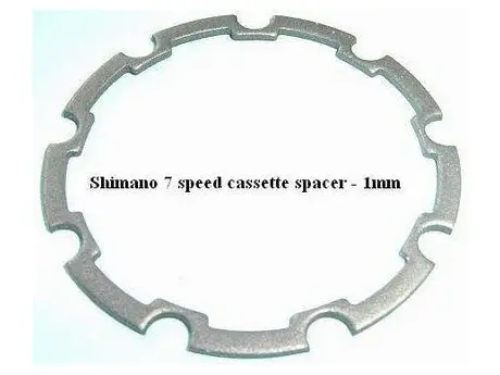

if you have 7 speed cassette and assuming you have a 7 speed freehub body then you might need this 1mm spacer, it goes between the 6th and 7th sprocket, without it the main part of the cassette will be loose as the lockring tightens down on the 7th sprocket and bottoms out before the cassette tightens, also the gears won't index correctly as 7th sprocket is too close to the 6th sprocket. cassette washer.jpg
