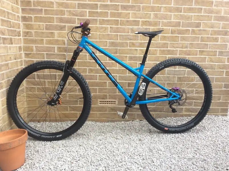

I've a wanted ad up for a set I need for a build, but in my search I've come across a few things and variations which have thrown things up in the air in terms of what's what.
I know there's stanchion diameter, then there's stanchion material, weight, travel, lower legs, damping, boost spacing etc. Then there's e bike forks too.
I started life thinking a set of 32mm rebas would do the job, but as mu frame is new and beefy, wondering if a step up to larger stanchions would be something to consider, something new for me.
If I consider just the rockshox range, there are various that use 35mm, but what is the real difference between them all as things look a lot similar to me.
I plan to build it up as a fairly light xc bike. Not trying too hard but using decent spec bits where I can.
So, on to forks. I get that RS TK silver is steel uppers Vs the gold lowers being alloy, but what are the real differences between the following forks as I'm a bit baffled by the similarity in some areas, chassis sharing etc.
So.....
35 TK gold
Revelation
Yari
I'm looking at 130mm ish travel, have seen various other options like fox 34, x-fusion, dvo but for my needs and modest second hand market budget, what would be the best bang for buck, and ideally available boos spacing fork?
Is it even worth stepping up to larger than 32mm?
I can't remember if it was your post or someone else's that I've recently waxed lyrical about them already, but I definitely recommend the Marzocchi Z2 which is basically a (slightly) more budget friendly fox 34 (34mm stanchions).
I think they have come up in a thread. The more I've read, they seem good but corners have been cut, down to things like no foam rings, barely any lube and a lower end damper. Apparently they (fox) recommend to fit foam rings when you first service them weird to scrimp on a part that must literally cost pennies.
Z2’s have an issue with no replaceable bushings I believe? Although they are great forks.
Personally I would want 34+ on a modern bike. Once you have ridden them moving back to 32 is noticeable, and I’m a featherweight.
Unless you are heavier (weight or use) I don’t see there is a need to add the weight and extra 1mm of stantion on the yari over revs or lyriks over pikes.
The rest is down to budget, but I’d rather some second hand revs for £200 than new golds or whatever else you could get for that price. Modern rockshox are pretty upgradable too, you can pop new air shaft in to change travel, change damper etc. so if you want can later upgrade.
Left field choice but I’m a massive fan of x-fusion forks as well.
Thanks, I'm usually an RS boy, know my way around them aside from charger so that's kind of my preference. Have read good things about x-fusion too. Keeping my eye out for either within my budget window. Pikes too, lyrik seem to be more travel than I'll need.
32's are noodley compared to bigger fork, to the point that even SID's come in 35mm these days! Only real difference between the Rev and Yari is the Yari's a bit burlier although the Rev is fine. The answer to your question (if sticking with RS) is Pike, however, much better damper and great forks.
Pike is a better Rev, same as Lyrik is a better Yari.
